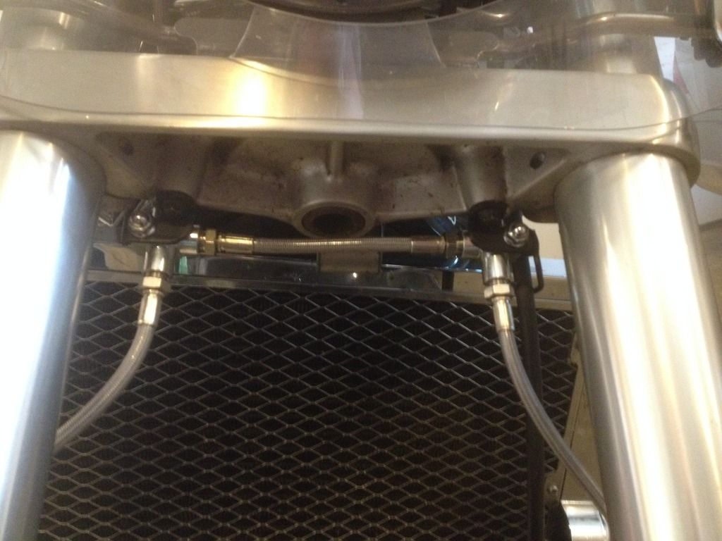

I rode over to J&P Cycles in Daytona and put together what I needed, all Russel lines. Used a single from the handlebar to a splitter on the lower tree, then two different lengths down to either side of the front wheel. Did the same with the rear wheel, measured it out, found the length needed and installed it. Had to order the clutch line, was too long and had to be made special.
I had the bike there that day and with one of their sales guys at my shoulder, I'd take a line out of the box and hold it up to the bike to see if it reached. After a few tryouts, all was done except for the installation. I don't like the looks or operation of the double line coming from the master cyl. on the handlebar. Simply not needed and more expensive usually.
