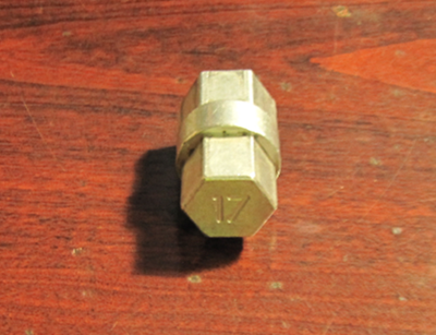

I use this axle wrench. Mostly I like the aluminum. And instead of 4 sizes stacked on top of each other, conveniently it has only 2 hex sizes at opposite ends, 17mm & 19mm respectively. Unfortunately I haven't been able to find it anymore. Anyways, you don't need two wrenches if the left pinch bolts are tightened first, per manual, since the left pinch bolts lock the axle from rotating, albeit there's still the one wrench, two wrench debate. In my case, I stopped using the two wrench method because you'd have to shift the left fork laterally to get it aligned which was easier to do with the axle loose. Yea, with the non-manual method of tightening the right pinch bolts first, two wrenches are necessary.
