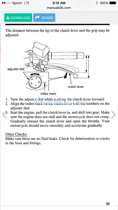

Wasn't sure, does the 1800 Valkyrie not have the adjustment dial on the brake and clutch levers? My F6B has the little dial that you can adjust to change up where the lever starts it's action.
Nope, no adjustment dial.  I ordered a black pair from a guy in the UK on eBay.  Kind of stupid that Honda went cheap on this.

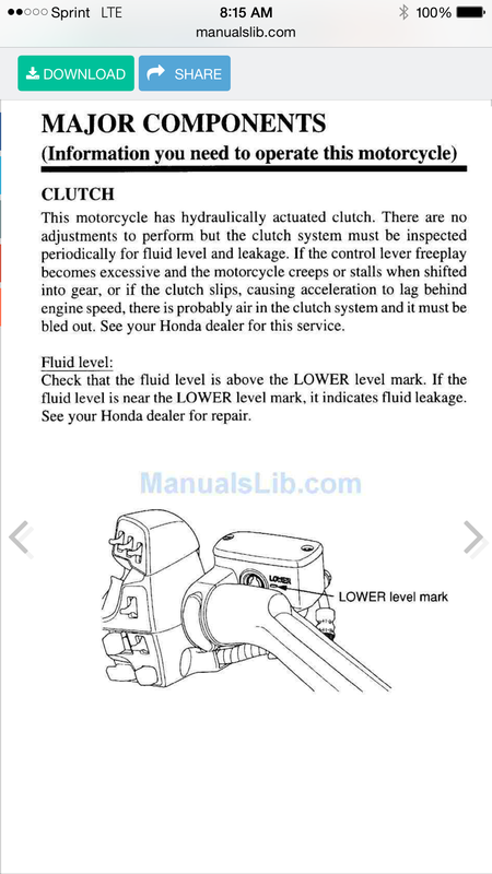

I understand this is from the standard Goldwing 1800 manual (so ignore the adjustment wheel piece) but interesting they describe the lurching forward issue. They recommend to bleed the clutch.
Again, if it's normal that our clutch just needs to come in nearly all the way down, so be it.

Don't feel bad... the F6B and Wing has the adjustable levers, but it only make about 1/8 inch of a difference on my Wing (2014 model).  I want about 1/2 inch to be "comfortable" with it.
Sadly, even with mine adjusted ALL the way out, the lever still has about 1/2 inch of play before it's at it's maximum distance.
One of these days I'm going to pull off the adjuster wheel to see if I can space it out a bit more (J-B Weld to the rescue!!).

Seems to have a much lower clutch engagement point than other cruisers I've had. Again, I need to squeeze the lever within half an inch of the handlebar to fully allow neutral from holding in the clutch.
From what our owners manual says (see above), this could still be the clutch fluid needing to be bled... The bike can lurch/surge ahead when put into gear from neutral, but once I pull the clutch lever nearly to the handlebar, all is well (revs go up, motor/trans separate)
