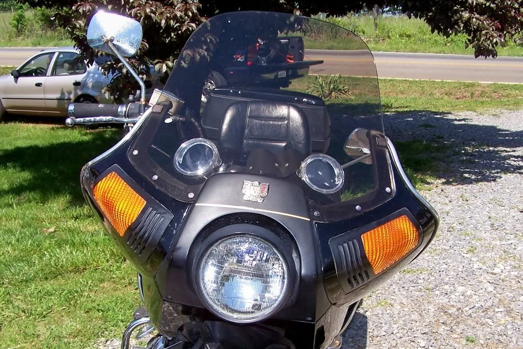

Cut your crummy old windshield down about three or four inches and you will not need to be able
to see through it. Then the haze will merely be a cosmetic flaw, and you'll get the chance to
see how you like a shorter shield before you buy a new one...
Here's my bike with my new 14 inch Clearview on it... I rode it for a day this way, not a
problem. Plus I can see GREAT on a rainy day, instead of peering over the top of an opaque
dirty wet tall windshield....
