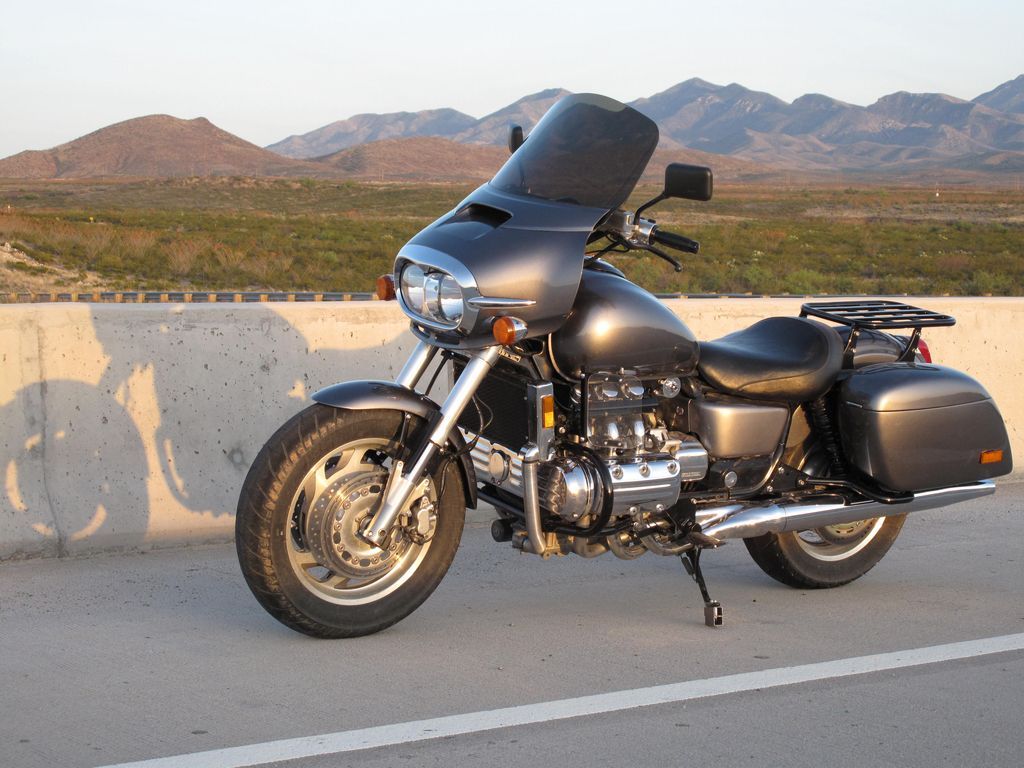

Dang that's a clean bike. Love the Hoppe fairing. Do you know what make the cruiser bar you have is? I got a used 1 the same for mine but don't know the make. Just that it is well built.  cooldude

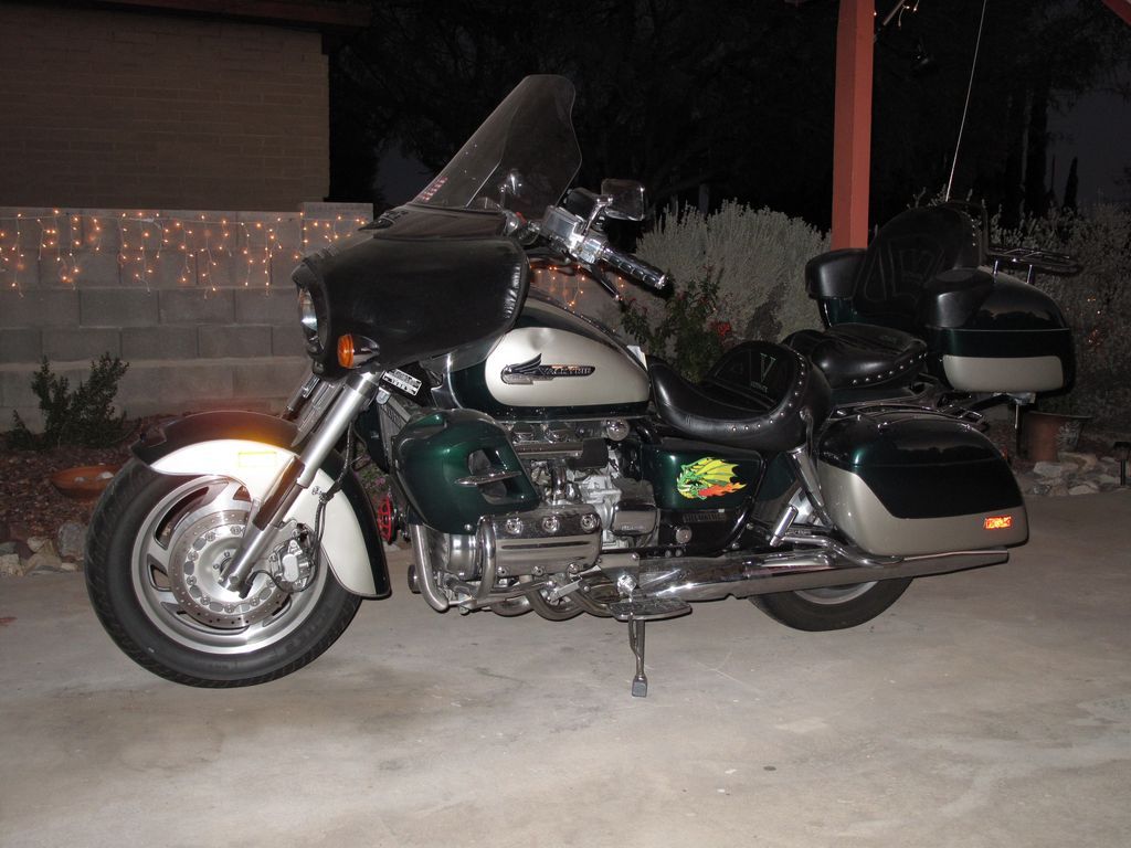

I agree with the OP, in that IMO of aesthetics...  Grin after a couple months of riding the old girl the pods just started detracting from the bike and hiding the engine.   Time for a ...
wait for it...
podectomy! Roll Eyes - Note that I did a search on the forum, and this word did not turn up - I'M claiming it  Cool

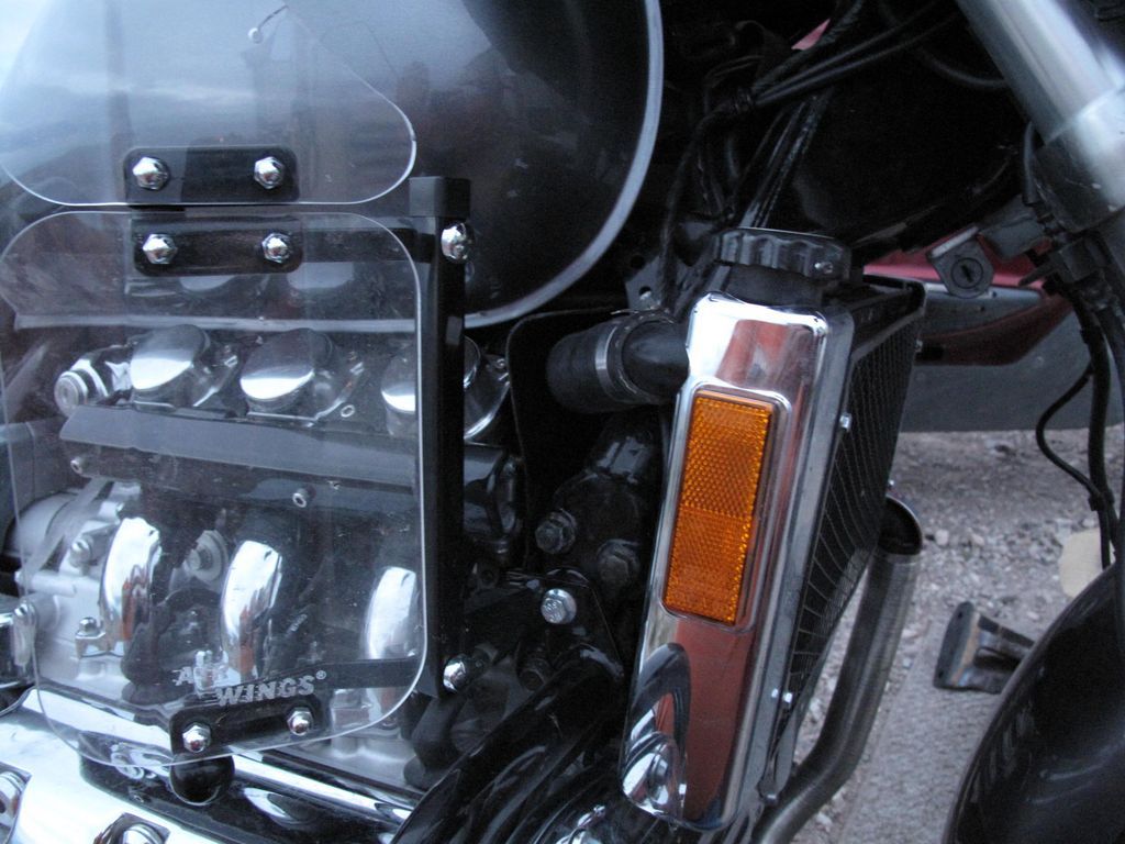

I just did this on my Solo and Hack IS Valks.  Radiators (IS and Standard) are indeed the same.  You do need the Standard brackets that allow fitment of the rock guard, as well as the Standard rock guards, and the chrome end caps and reflectors.  But it sounds like you were able to trade, so you should have the hard parts covered.  You also just saved about $200...   All this stuff is still available from Mother Honda.
As several posters indicated, the plastic heat shield is different.  But you do not need to get a new one; as long as you have a Dremel (and some experience) and a free afternoon with some amber refreshment.  Pulling the radiator is the easier way to do it.  It can be done with the radiator on, but one 1/8" deviation with the dremel and you will nick your frame paint, your tank, or carb cap, or radiator hose...  Easier to pull the radiator, and while you're at it, replace those 15 year old hoses.  And maybe the radiator cap, as both my rubbers seals were gone, and the cap was rusty.
Below is the result of what trimming the IS heatshield looks like - note that it takes the Dremel metal cutting blade, the 1/8" carbide bit, the football looking bit, and finally the sanding drums with 80 and then 120 grit sleeves.  If you want to get really anal, you can actually polish the end of the fresh sanded cut plastic to make it look factory; I stopped at the 120 grit sanding drum:
Be warned though, that the podectomy on an IS can, like a tummy tuck on an aging trophy wife, lead to other bulk reduction endeavors.  A nose job, some chin work, massage the cheekbones, some careful boob work, and a rear end lighten and lift later, the old girl will look 20 years younger and 100 lbs lighter...
Before:
And after:
The Standard Baker Wings (with a little surgery, depending upon your fairing), in conjunction with the fork air deflectors handle air management superbly.  Dang these bikes are fun...  cooldude
Wow, the cruiser bar?  That's a good question.  I picked it up a long time ago...don't know where.  Something makes me think it is a LaMonster product.
Yes, the Hoppe fairing with the I/S pods give good protection in foul weather.

« Reply #23 on: April 26, 2015, 08:38:00 PM »
With the indulgence of the OP... coolsmiley
I could not find anything I liked (happens to me a lot it seems  laugh...) so I built one.
Get (2) Hondaline luggage racaks off ebay ($40 used, $100 new), and cut them in half to the length you want, make some solid inserts to slip into the round exterior frame, as well as the thin rectangular tubing.  Weld, file, braze, file, weld, bend, braze, then sand to the smoothest contours you can - powdercoat will hide more deviations than chrome.  Then get a pair of Standard rails with the rear ears.  Then buy an aftermarket Valk luggage rack from ebay, toss the luggage rack and backrest in your metal pile, and cut to shape and weld the "ears" onto the Standard rails in a spot that clears the seat, and matches up to how you want to mount the rack.  Then make four tangs about 3" l x 5/8" wide, notch one end to match the bottom of the rack perimeter rail, then weld and fill.  When done, slip the tangs into the original bolt-on ears on the Standard rail, as well as the welded ears.  Drill holes, bolt up, take apart, and powdercoat.  Special note: when you powdercoat, your handiwork will shapeshift a bit...  But if you heat it up first (like let it sit in the 90F Tucson sun a couple hours, too hot too handle without gloves) you can bend the tangs back in shape without the powdercoat cracking.
All told, took me a couple months of weekends, maybe 2-3 hours/day.  I can tack and burn thru anything, and my grinding skills continue to improve.  But I weld about like I play basketball... crudely.  So I generally would make the pieces, cut to fit, prep, and tack.  Then take to a good friend with a TIG.
I'm happy how it turned out. Wink

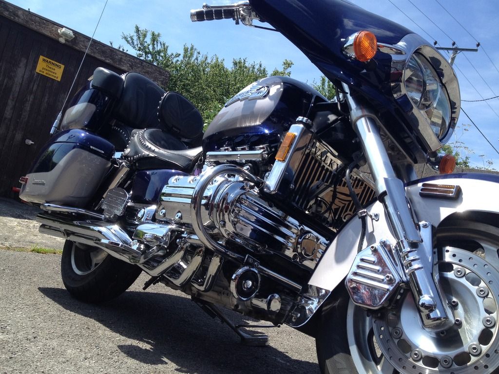

Well I did it, I removed the pods and fitted standard parts. What a job getting the plastic heat shield out. Im very pleased with the look and if I like it others will too.Only thing is Ive completely forgot how to add photos  Embarrassed
If someone can remind me how, ill post the results .
Cheers

« Reply #26 on: June 19, 2015, 02:47:48 PM »
[img][/img]
knockdolian
Posts: 153
« Reply #27 on: June 19, 2015, 02:50:02 PM »
PAVALKER
Posts: 4435
Pittsburgh, Pa
« Reply #28 on: June 19, 2015, 03:21:21 PM »
Wow.....now if you remove the trunk and fairing you will have a look similar to a Tourer, and if you then remove the bags....a Standard.
You have any intentions to go further?
