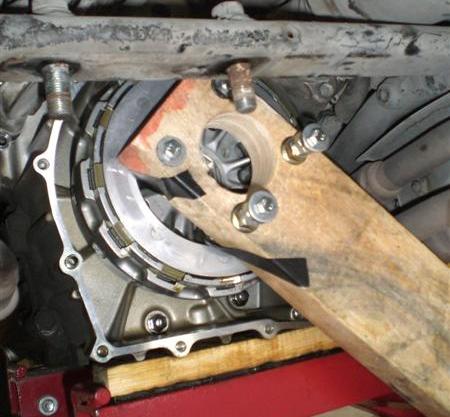

Rented a 32MM socket from Autozone... Tried to get the clutch internals nut loose with a breaker bar last night. I will HAVE to build the "special tool" to hold the clutch still whilst I "reef" on the breaker bar.

I made one out of a 2x4.  An impact wrench works, too.

« Reply #6 on: April 28, 2015, 02:01:03 PM »
Here's a picture:
Thank you, Sir! I will be making a tool tonight, if I can get home from my 60 mile commute before Tacoma Screw closes... Need to get some longer bolts for it. I cut some "al-loo-min-ee-um" tubing 7/8" long for the spacers around the lower portion of the bolts.

Clutch woe blow!
My Honda special tool clutch holder worked great. Removed the clutch pack from the bike.
A friend came over, hauled the clutch pack & I to the shop he works at, and we disassembled the clutch pack. One rivet was already missing. Another fell apart and out of the dampener into my hands! The basket has no damage, thank God.
Well, started to stack the new friction plates, dampener plate. When I got to the first steel plate, found it was badly burned, second also burned, third was burned too but just minor. Not wanting to risk it, I will now go order ALL new steel plates...
