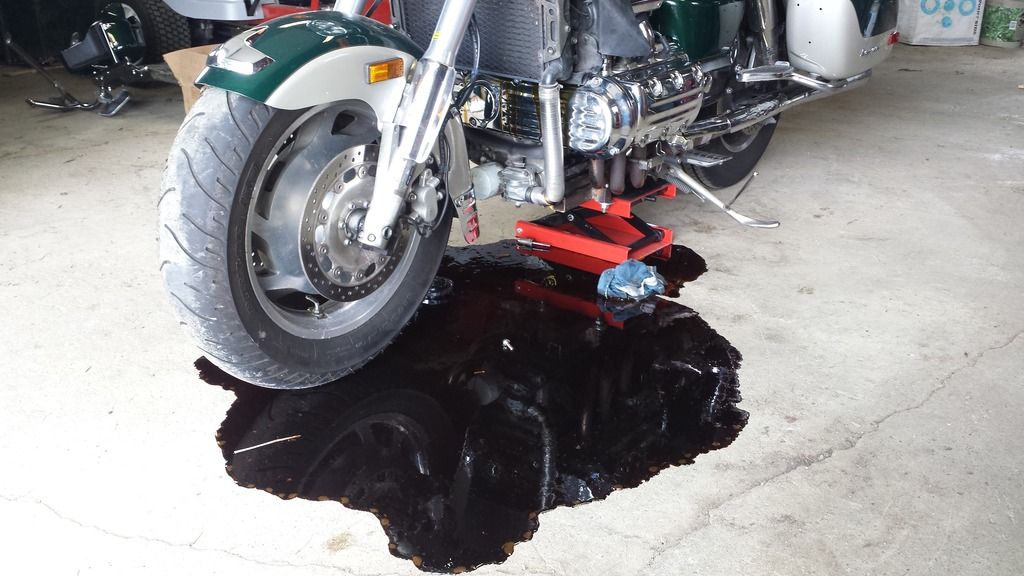

I have spent the past three evenings and most of today working on my girl.  Desmog, new vac line from #6 to petcock, new intake o-rings, new exhaust o-rings, air filter, etc.  I buttoned her all back up and fired her up and she poured oil all over my garage  floor.  It is coming from somewhere on top of engine and running down left side and down front of timing cover.  Am walking away for a while as I am not looking forward to pulling tank and air box again so soon.  Any suggestions as to where I erred would be appreciated.

u need to re-install the bolts on top of engine which were used to hold the pair valve brackets. its an open path to the crank case.

Yes, CA hit the nail on the head. I forget which one it is so replace all of them and you'll be fine. Might want to use a dab of sealer on the threads as well.  cooldude

I 've never had that happen and have never put them bolts back in...   Guess I was lucky.....
Guess I'll start putting them back in cause I sure don't want to clean up that mess....

« Reply #6 on: June 06, 2015, 04:32:51 PM »
...and change that oil! Wink

« Reply #7 on: June 06, 2015, 06:23:08 PM »
It's most lovely when what you think could be a major disaster turns out to be a simple fix.
We all make mistakes at times, we just have to learn by them.
Replace the bolts, change oil + filter, then get out and ride it.....

Yes replace the bolts.  I always cut them off about half their length and screw them back in.  You may be able to take the intakes off of one side and get to them or take two of them off and let the third, either front or back hold the carbs up to allow you access.

I tend to remember it was the center bolt which actually held the pair valve bracket to the block. on mine I could see the crank with the one bolt removed, air box was out at the time. one of the early de-smoggers wrote about the bolt opening to the crank. It was verified when I did mine.
maybe u got lucky and yours was being drilled at the end of a friday shift before a 3 day holiday wknd and they never finished?  Grin  actually a good thing!   cooldude

I just removed my pair valves and did reinstall the bolts. I did my own variation of a stealth de-smog. I don't recall reading in any posts or instructions that those bolts needed to be put back, not saying no one hasn't mentioned it, I just don't remember seeing that step. I only did it because I can be just OCD enough that I didn't want to leave the holes open.
The bolt holes did not appear to go all the way through. Once removed I blew the holes out and reinstalled the bolts with a dab of anti-seize since all the bolts had some slight rust and oxidation from being in holes that seemed to terminate and hold moisture. The bolts all seemed to bottom out at the same depth which was just short of the length without the pair valve there to act as a spacer to use the extra bolt length.
