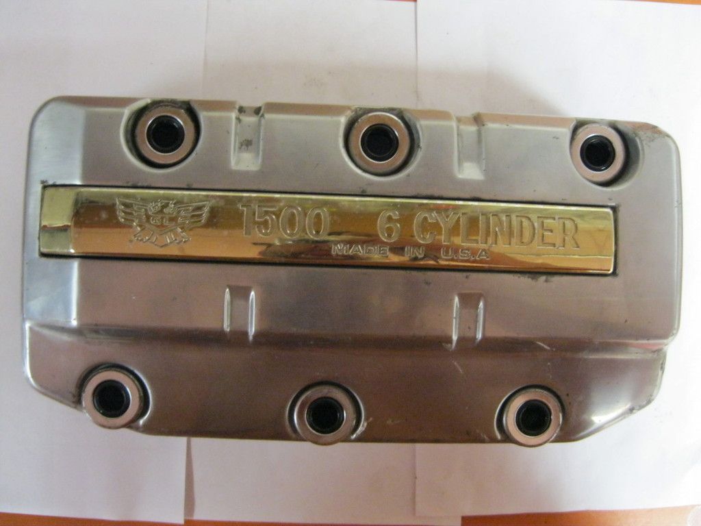

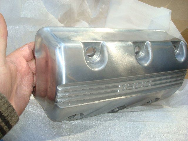

I bought these.
Then there are also these ones.
The difference are these inserts, which can be replaced.
Rude Dog used these ones. Looks like they are being polished.
I wasn't aware of the difference in bolts. I think they came with the GW bolts, but it's been a few years since I looked at them.
I believe they are all interchangeable between the right/left. There is only "one" style mount for them all, so year/model doesn't matter. Only what you want, and how you want it to look. I was wanting the 1500/6 for the Valkyrie, without the GW eagle emblem. I liked the chrome center piece more than the "1500" on the side.
