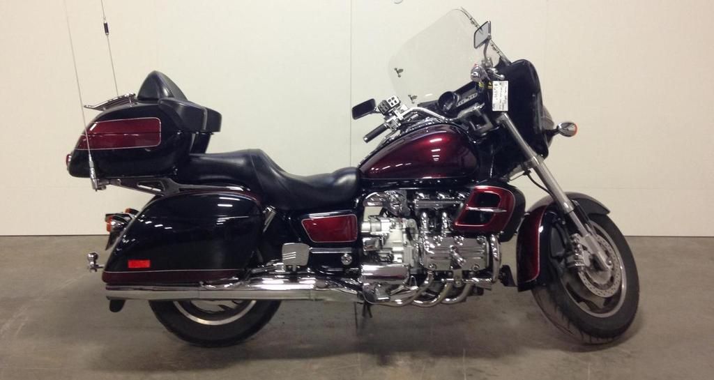

I noticed on my new to me 01 Valk I/S I have a slight low speed wobble starting around 15 mph, I only notice it when coming to a stop, the front seems to want to wander a little.  Today I jack the bike up and check it and could find no front to back or side to side play so I pulled the front wheel and check that, seems to be balanced well and bearings seem fine as well as the tire, Avon cobra.  With the wheel off I check the steering and I do have a slight notch in the bearing, I can feel it fall into it with I straighten the bars without the wheel on so I plan on replacing that this fall after the riding season here.  While I couldn't find any play in the bearing it seemed to move a little to freely when turning the bars I expected to feel a little more resistance.  I'm not experienced when it comes to the steering head so not sure if it just my imagination or not.  Just wondering what others experience is when it come to the steering head.  Is it possible the notch if feel in the bearing is the whole cause of the wobble or should I be looking at something else?

No real suggestions on the name but Dayum she is purty  cooldude
I like custom paint as ya can tell angel tired of seeing the same Ol factory stuff angel

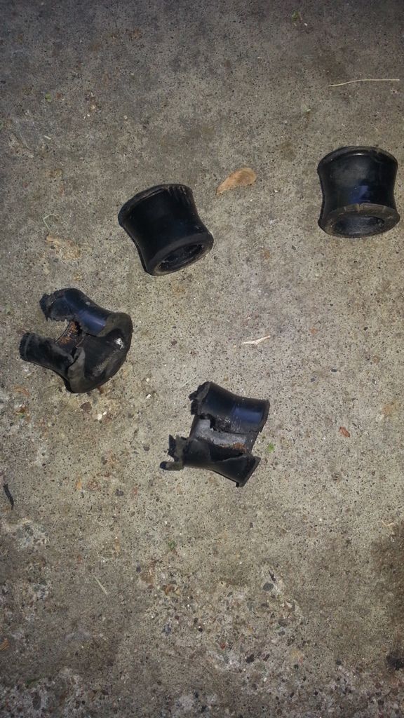

Took a quick look at the rear shocks and the top bolt is not centered on the bushing, according to some of Chet's info on Rattle bars that tells me the bushing is bad so i'll be replacing them hopefully this week if my local Honda dealer has any of the VTX poly bushing in stock.
Father I was only able to barely feel the notch after I pulled the front tire and pulled the calipers out of way.  I hoping the bushing help with the wobble, I will update, thanks for all the suggestions.

Quick update I can't believe how hard the bushings are to find.  None of the Honda dealers here in MN stock the poly bushings (52489-HN0-671) and I couldn't find any in stock at the major part houses.  I finally tracked down 4 of them at Coffey County Honda in KS and they're going to mail them to me.  I couldn't even find the standard rubber bushings here in MN.

Update my bushing showed up today so I threw them.  The old uppers were shot but the bottoms weren't too bad but now I have the poly bushing all the way around
The wobble is a lot better but still a little there the change was noticeable.  I'm going to pump the front tire pressure up a little it was sitting at 38 so I think I'll try around 42 and see how it goes.  Appreciate all the info from everyone, thanks again.
Posts: 31095
« Reply #24 on: June 18, 2015, 06:45:19 PM »
Yeah, I'd say those were a bit worn.  Grin
