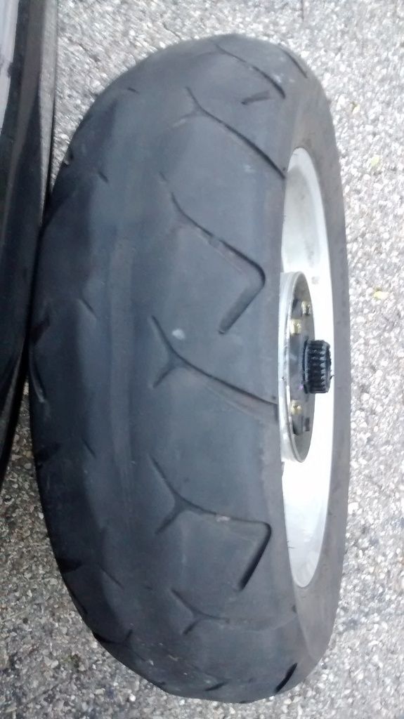

Guess I'm not going to make it another thousand miles.  Dang.

like to know what kind of tire that is so I never by one, that's been through the wringer.

It's a Bridgestone G702 radial.  In all fairness I have no idea how many miles it has as I bought the bike this spring.  The last 2500 were mine, and it handled progressively worse but I had no idea the belts were showing.  Yikes...
« Reply #4 on: June 15, 2015, 07:57:27 PM »
Any motorcycle tire ya run on the rear should carry around 45 to 50#'s
If ya run a car tire, start at 28#'s  and progress up, but do not go over 38#'s in a CT on the rear.

It was at 28 psi when I bought it, the previous owner liked a "soft" ride.   Roll Eyes  I bumped it to 42 and it was fine for about a thousand miles but then got squirrely, so I dropped it to 38 which settled it down, for a while.  It hasn't been much fun in the curves as of late, and coming to a stop it's been a PITA to handle.
A Michelin Commander II goes on tomorrow.

There's not one single thing on a motorcycle more important than your tires.  Pay closer attention to them (and the pressure).
A decent tire that should have 40-44lbs in it can be ruined running at low pressure (and it doesn't take that long), and thereafter cannot really be saved by adding air.  You can run up to the MAX PSI printed on the sidewall, but higher than that is not recommended.
I run 40psi in my car tires, constant.
I just finished a Commander II radial 130 on the front (they only make a bias 180 for the rear).  It was an excellent riding and handling tire with even wear, but was done at 7300 miles (41psi - 42 MAX PSI on the sidewall).

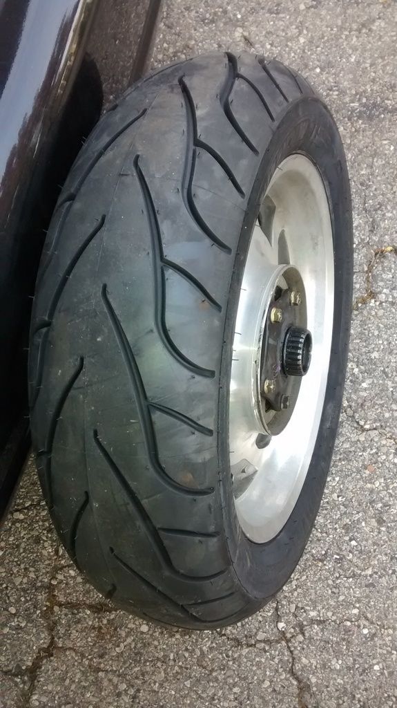

« Reply #12 on: June 18, 2015, 05:27:07 PM »
Progress.

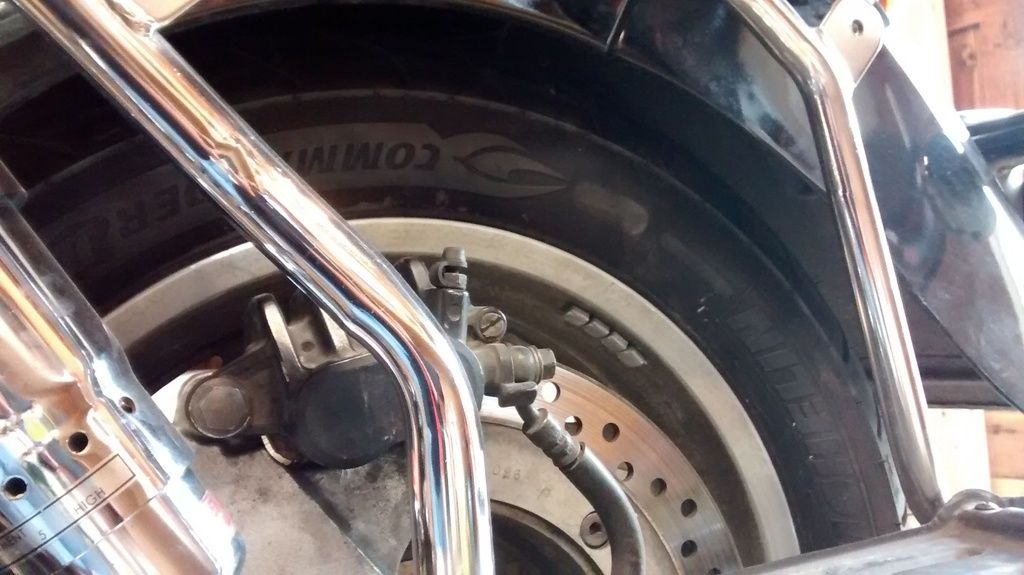

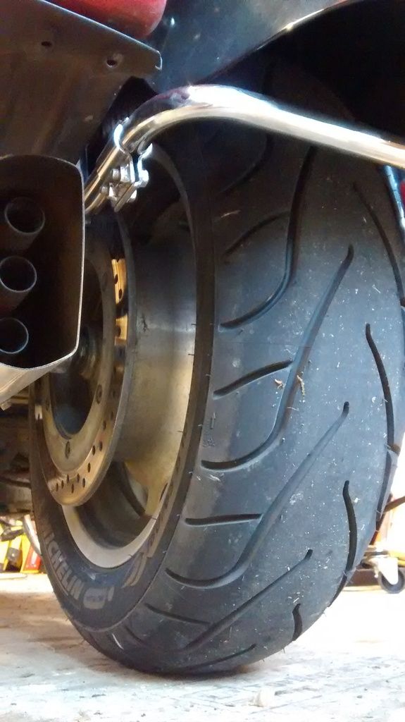

Happiness is new shoes.  Smiley
« Reply #14 on: June 22, 2015, 06:14:56 PM »
That Michelin looks GOOD on there.

« Reply #15 on: June 22, 2015, 06:19:54 PM »
Initially the tire hopped when leaned over and on deceleration until I pulled the 20 grams of stick-ons off and it went away.  And to think I paid for that.

« Reply #16 on: June 22, 2015, 06:45:46 PM »
Thank you!
My wife commented on how smooth and comfortable the ride became.  The handleing seems fine, ANY new tire would after riding on that Bridgstone but what I can't get over is how quiet it is.  The old tire wasn't particularly noisey but the Michelin is whisper quiet.

My research showed it was only around a quarter inch shorter than an OE size tire, and that should make no difference whatsoever.
