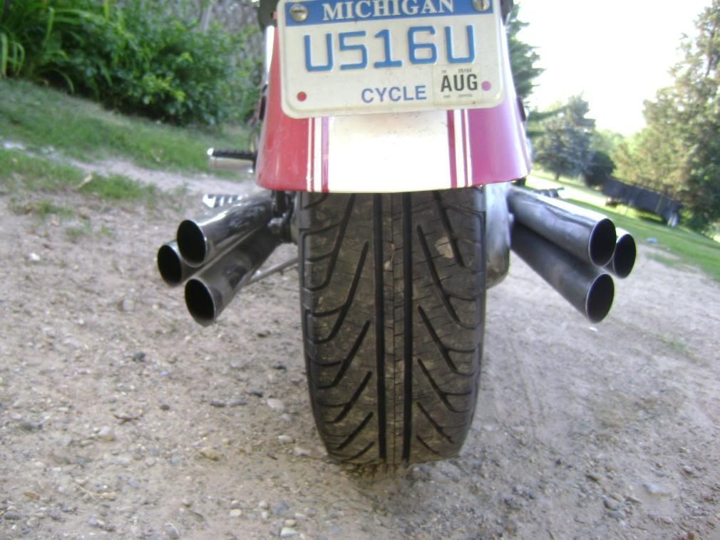

« Reply #13 on: September 02, 2009, 04:04:14 PM »
that is a cool looking tire
heres mine
« Last Edit: September 02, 2009, 04:06:17 PM by partytyme » Logged
