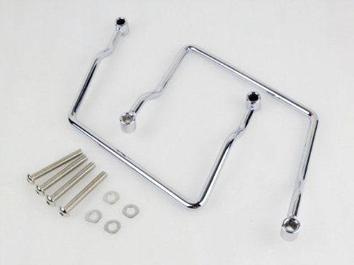

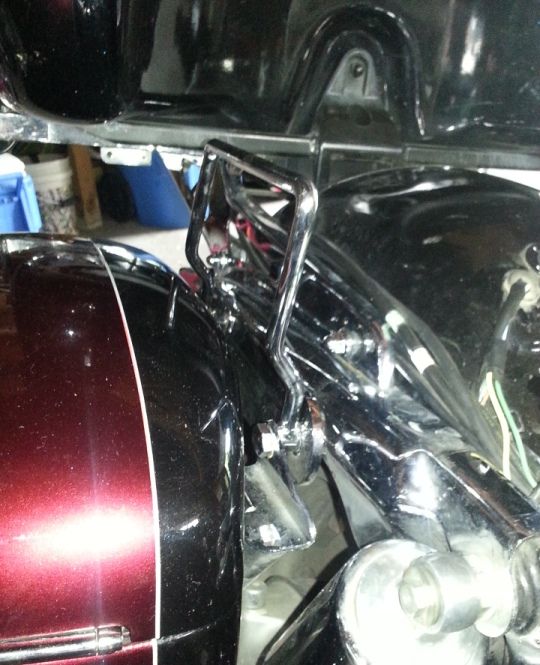

My wife has been complaining that there's nothing good to hold onto when she's riding with me so I found these
They are Saddle bag mounting brackets for a Yamaha Vstar I happened to find while looking for some for a friend.  Bolt collar to bolt collar they measure 8 1/4 inches which just happens to be the same as the two holes in the side rail the saddle bag brackets bolt through into the rear fender.
As you see from the pics below I also have a hitch on the bike and the bolt hole collars on the supports were thicker than the spacers between the saddle bag bracket and the hitch plate so I had to grind them down so they were the same thickness as the spacers, I didn't want to go buy new bolts.
I only have one small concern and that is that the bolt hole collars are not as wide as the spaces I took off, I wouldn't think that would affect the hitch much but I'm not sure.

I paid about $29 for the pair.  I've looked around and haven't found any other solutions for the Interstate.  If someone has one I'd sure like to see it.

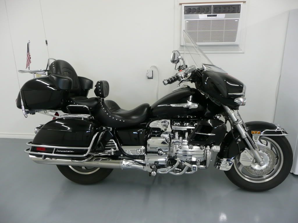

The seat is a factory seat I just added the drivers backrest.  I'm sure they would work with any of the seats.

Just looked up the order, I got them off Amazon.
Chrome Saddle Bag Support Bar Mounts Bracket for Yamaha V Star XVS 1100
http://www.amazon.com/gp/product/B00GI9FB8S?psc=1&redirect=true&ref_=oh_aui_detailpage_o04_s00
Have a good one.

Well spring is almost here in Ontario Canada and it was time to work on the bike.  I received the luggage stand off bars to use as grab handles on the Interstate and they worked out perfect.
Thanks again for the effort to list where they came from.
I added some pics here to show how they worked out with my new mustang seat on the Interstate ... just in case anyone else was considering this option.
Also on another plus note > I have a center stand on the bike and there was a lift handle on the left side that wouldn't fit with these grab rails.  Great news > the grab rails provide enough lift for me to still put the bike up on the center stand.
