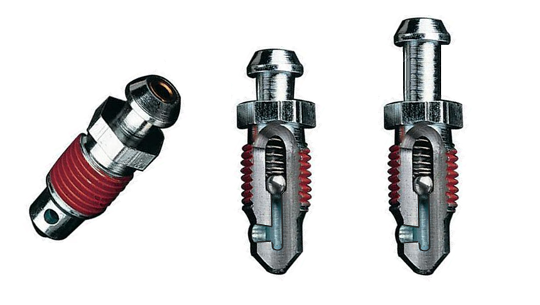

Word of caution...make sure the master cylinder is drained enough so you don’t overflow brake fluid all over your bike from the master cylinder reservoir.
Also, I am a fan of speedbleeders for making fluid changes no mess and a one person job.  Don’t forget to order the bladder bag and tubing to catch the old fluid...no leaks, no mess.  I also have a mity vac for wetting and initial filling brake lines (using standard bleed nipples ) with fresh brake fluid, then install the speedbleeders to finish the job.  Once this is done then the mity vac isn’t needed and speedbleeders will handle future fluid changes.  Synpower DOT 3/4 is my fluid of choice.  I change all fluids yearly whether they need it or not.
I install speedbleeders on all my bikes and also my friends new bikes at periodic wrench parties.

« Reply #24 on: July 18, 2019, 09:38:44 PM »
I'll say ditto to all 9Balls post. cooldude

« Reply #30 on: July 20, 2019, 03:21:26 AM »
Install Speedbleeders and I swear you will never bleed brakes or your clutch by vacuum or gravity again.  I have them on my bike and installed them on my longbed crew cab when I changed the brake lines, those lines are long....... but bleed so easy.  Add the bladder bag also, it has the best bleeder hose I have ever used, it never pops off.   cooldude
I installed speed bleeders on one bike. They worked just fine, but honestly, once you use the bleed tool I mention above, you’ll never do it any other way. For the price of just 2 speed bleeders you’re good to go for all your vehicles.
Speed Bleeders are the ONLY way to go.  Yes, get the bag.  cooldude
Yes, get the bag.
Absolutely, get the bag!
I bought a bunch of bags, but you could reuse them if you like.

The YouTube videos focus only on installing the Speedbleeder. Probably, because bleeding is done almost the same way with a wrench. The difference is that you just stand by the brake lever and keep filling the reservoir so it doesn't run dry. Where with the wrench method, it was crucial to re-tighten the bleeder zerk before releasing the brake lever, there's no re-tightening the nipple with the Speedbleeder. When you release the brake lever, a one-way valve keeps air from seeping back into the bleeder nipple. So, it's not necessary to run around the bike to retighten the nipple or have a second person. If you don't plan on permanently replacing the oem nipple, than the Speedbleeder with the longer spout makes a securer connection with a bleeder tube. Or, you could snip off the end of the bleeder tube when the end develops a flare. Not sure, but the clutch bleeder might need the Speedbleeder 'LL' (below) otherwise it might not seat. Only Goldwings are listed on the original Speedbleeder website ..... GL1500.

I like to use a small vacuum spring clamp on the plastic hose to keep it from falling off.... Also if possible to use the SB8125L, I will go for that, because of the slightly longer nozzle to grip on.
I will never even plan a bleed job without having the speedbleeders on hand to install.
