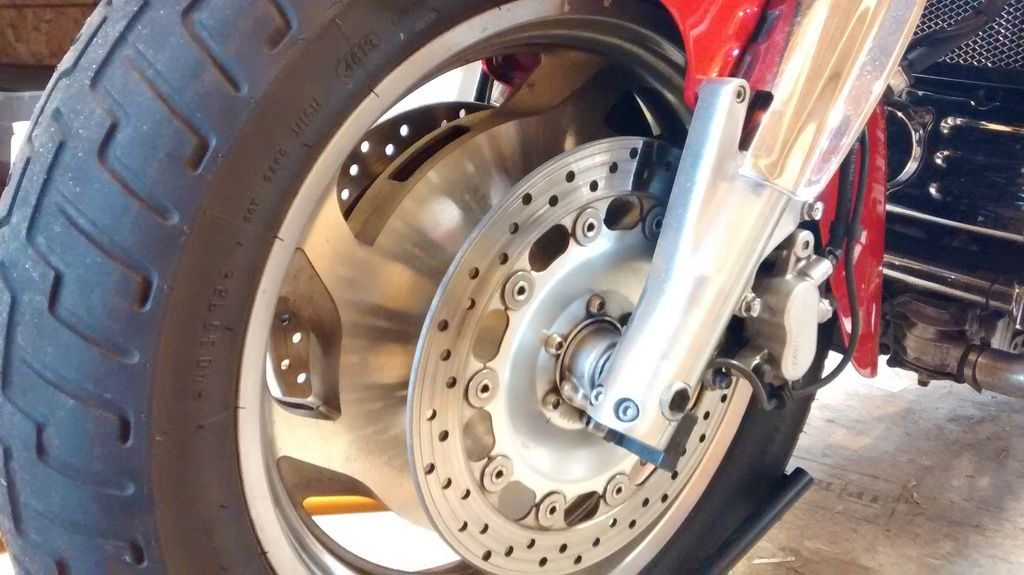

My I/S came with a new D404 on the front about 3,000 miles ago and I cannot seem to warm up to it.  It rides harsh, is noisy, and on tar snakes, well let's just say I just about shat my pants a few times on otherwise nice hot sunny days.  Highway speed and parking lot maneuvers both, the tire simply lets go.
The only other front tire to give me such fits was a five year old E3 and I almost parked the bike (GL1200) after a near low side on a right hander with a little gravel.  I checked the date code and this 404 is about a year and a half old.
I did recently replace the rear with a Michelin Commander II, perhaps the tires are mismatched?  They are both bias.
The 404 seems to be an extremely popular tire with good reviews.  Any thoughts?
