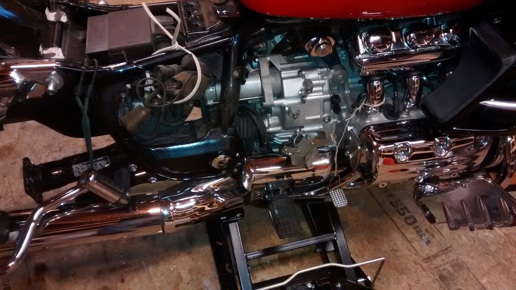

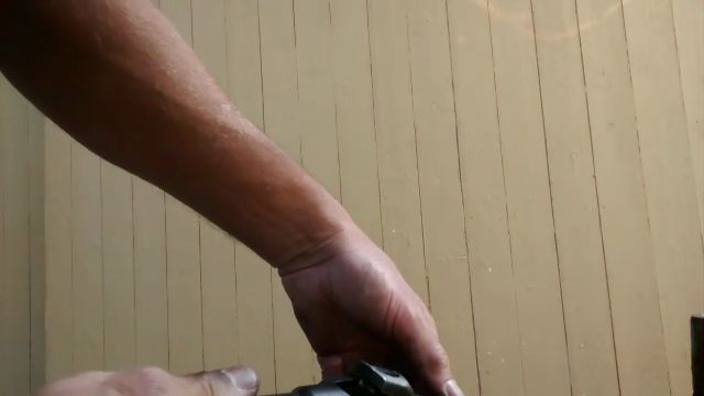

« Reply #7 on: July 02, 2015, 05:29:14 PM »

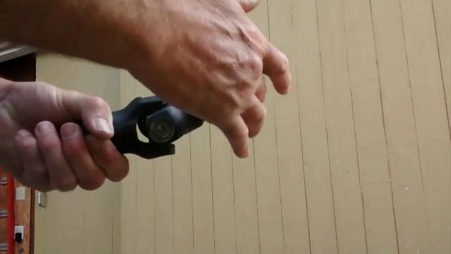

« Reply #8 on: July 03, 2015, 06:01:33 PM »
New u joint:
