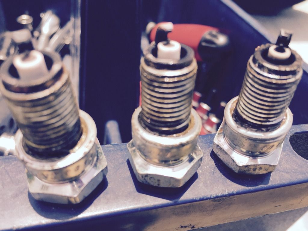

Based on fuel consumption, smell, sooty exhaust coating ( will blow black specks on garage floor when engine is raced ), and finally a sooty spark plug from the # 1 cylinder, the right bank is running very rich. As original, there is not a vacuum line connection to #1.
The right bank plugs are picked below. #1 is on the right. The plugs are NKG Iridiums that I installed about 4000 miles ago.
It is '2000 with 20,000 miles of which I have rode 12,000 during the past year. It has never burned any oil whatsoever, does not puff blue smoke on deceleration and the tailpipe soot is not  slick/ greased as from oil from oil.
It now hits reserve at +/- 95 miles. Big BF checked it over during InZane & adjusted the pilot screws and verified the recent DigiSync I had recently done as being correct. Before his adjustments, it was hitting reserve at+/- 75 miles.
It is a trike which will somewhat adversely affect mileage, but not this much.  Also, it has .38 low jets installed by the PO.
In the course of double checking things yesterday, I removed the #1 main jet & diaphram. The diaphram was out about 10 minutes before I began to reinstall it and I discovered that the "seal" around the outer circumference was distorted and pinched, indicating that it had not been properly installed. I massaged and gently reshaped it and put a few dabs of silicone paste in the groove to hold it in place while installing the cover.
Could the diaphram have been the cause?
What about vacuum problems even though # 1 is capped off. (With a new cap)
What else could be specific to # 1? Float valve?
Any help would be appreciated.

I don't understand. What is the question.
Those plugs look Ok to me and that is not the correct view of a plug
if you are looking at the plugs for running condition.
Here:  http://www.dragstuff.com/techarticles/how-to-read-plugs.html
Dan
Ricky D:
As to "what is the question", absent your inferring that I'm asking why my Valk is burning too much gas, three specific questions were posed:
The three questions were prefaced by what I deemed to be relevant facts tending to rule out some likely possibilities and, conversely, to suggest other possibilities. Those facts include: sync and pilot screws recently set by a well-known, top-notch Valk tech ( Big B.F. ); the right exhaust blows gasoline soot; the #1 spark plug is sooted, while all others are normal; the #1 jet diaphram was discovered to have been improperly installed; the engine has burned no oil over 12,000 miles to my knowledge; the "soot" I complain of is not of oil origin ... you get the point.
I concluded my missive with the statement "any help would be appreciated" following my three questions regarding what I thought could have been some possibilities. I assumed that by asking for help, it would be understood that I was seeking other possibilities as to the cause of my problem and/or the accuracy/inaccuracy of the possibilities I posed.
I appreciate your referring me to the article on reading spark plugs. However, I'm not concerned with evaluating heat ranges for dragster engines. It's pretty simple reading when five look great and one (from the rich side) is sooted up enough even to be discernibe in my lousy photograph.
So, as to what is my question, the one I pick which I know least about would be: Could the mis-installed diaphram at #1 cause the problem, or do you think it is more likely a sticking float valve, and finally my biggie; what else is specific to # 1 that would cause it to run richer than the others given that it's vacuum port is plugged?
I hope this is sufficient detail as to what is my question (s).
Dan
« Last Edit: July 10, 2015, 06:27:38 AM by DK » Logged
Machinery has a mysterious soul and a mind of its own.

First off, I suggest to replace the spark plug. It may be faulty. If you have corrected the diaphragm problem and it was the cause, you should see the results on the new plug. A sticky float bowl needle or float can and will possible lead to loading the cylinder with gasoline, which you can easily notice when the engine is idling. Easy enough to check the performance with the float bowl removed. The #38 jets are unnecessary and contribute to your problems.

I completely agree with you about the .38 jets. They were installed by the P.O. & im going to change them out hopefully within the next couple of weeks.
When I put the plugs back in, I switched the #1 & # 5 plugs to see if the #1 plug was bad.
I haven't had a chance to ride it since discovering the diaphram problem other than just some short errands.
I failed to mention that it "bogs down" in high torque situations when given full throttle all at once, but if the throttle is smoothly and progressively opened, it accelerates normally with good power. I think the diaphram may have been responsible for this. We'll see soon.
Thanks for the advice,
Dan

It might be just the angle of the photo, but, those gaps look way too wide...... crazy2

Ran the Valk 300+ miles today. She's running with the big dogs listening to Bob Seger again.
The mis-aligned diaphragm definitely was the problem.
Im going to check the sync just to be sure the bad diaphragm didn't affect the previous sync & I'll check the plug after 800 or so miles.
Thanks, everyone, for the helpful suggestions.
