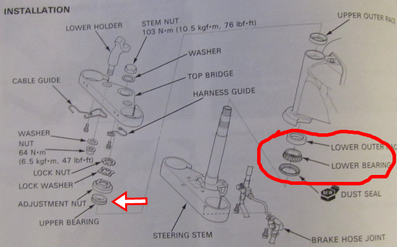

« Reply #8 on: July 15, 2015, 05:52:45 AM »
Is the manual correct in that the top steering stem bearing is a ball bearing? Lower bearing tapered.

« Reply #10 on: July 15, 2015, 10:45:23 PM »
Photo below is from the manual, *arrow* points to the steering stem's upper bearing. I did check the Oem websites and the same top bearing is indeed a tapered bearing. I was just browsing through the manual yesterday. And it caught my eye.
