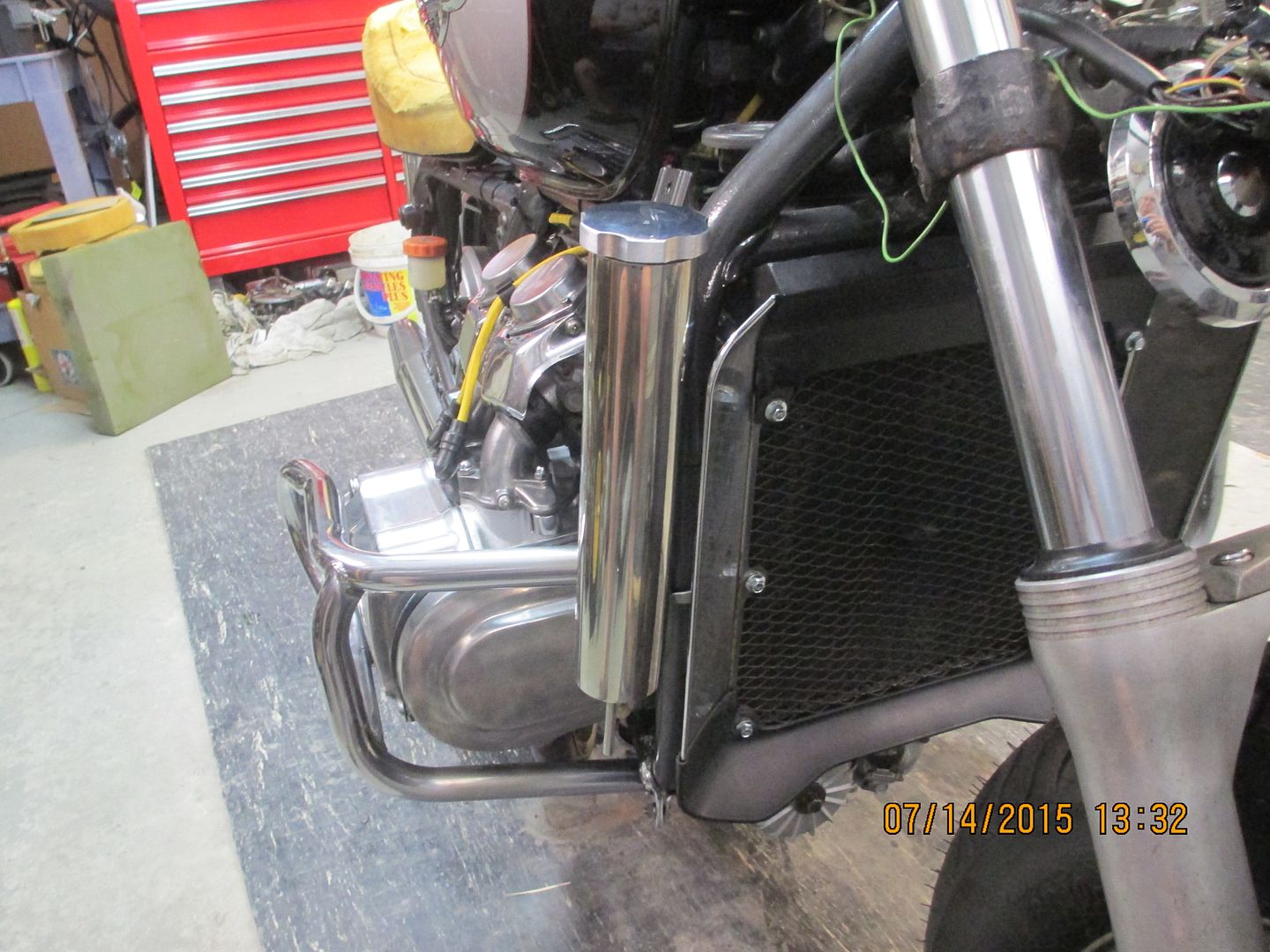

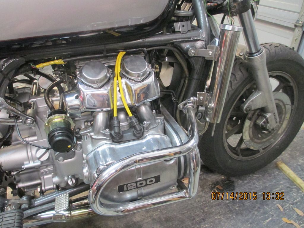

Can't use the ugly OEM plastic unit with the Valk tank mounted, had a hole in it anyway. I just kept it simple, ordered a 2"x 10" polished SS tank off Ebay, $28 with s/h. Holds about 18 oz which is slightly more than OEM. Used a P clamp at the bottom off the engine guard, an SS strap up top, it's solid. Used clear tubing so I can tell how much coolant is in there without removing the cap. I guess it looks OK, definitely functional. Now on to the forks.  cooldude
And no....the forks don't come anywhere near it at full lock.  cooldude

« Reply #1 on: July 14, 2015, 07:30:30 PM »
Pretty trick John and it looks real nice too. cooldude  Your putting a bunch of personal touches on this thing...I thought you were going to flip it?  coolsmiley

« Reply #2 on: July 16, 2015, 05:40:47 PM »
John do you remember when the older radiators only had a hose that ran along one side or the other and dumped it on the ground?  Have we all become more environmentally conscious or did radiator cap technology change?
Posts: 15383
« Reply #3 on: July 17, 2015, 11:53:38 AM »
Probably a bit of both, yes....I remember that. A long time back I read where it's better for the engine to not lose the coolant, but to have it be retrievable as it cools. I guess that's where the overflow idea started. I also recall the tubes from the valve covers just hanging down below the engine instead of recirculating the fumes. An old engine with a lot of blow-by was easy to spot back then, just follow it down the road and watch to see what kind/color of fumes it was blowing out from underneath. That was back when most engines were ready for replace or rebuild at 50k.

Eddie, here's a side shot taken this afternoon. I spent some time creating a panel to go in front of the carbs and behind the frame downtube, cover the area where you can see the radiator hose. I have the other side cut out, it's a little oversized so will take some trimming but the outer surface is polished SS sheet. Also need to create a piece to cover the area in front of the tank. It originally had a plastic piece in there but no longer fits. I was experimenting with the side panel, have filled some holes with JBQuick, dried overnight and three coats of primer on it when this pic was taken. I want to make the first coat a solid silver gloss to match the tank, then the outer perimeter a gloss black. Wish those side panels weren't so big. If this one turns out OK I'll do the same with the right side. Still need to have to tubing made to kick the muffler out and up a bit. They now hit the frame on the right side and the centerstand arm on the left side hits the left muffler. Probably will do the forks, calipers and front wheel first.
« Reply #8 on: July 18, 2015, 03:13:42 PM »
From what I can tell, that looks exactly like the one I had on my 39 Chevy Street Rod.
After the fire, that is the only thing I salvaged off of the car.

« Reply #10 on: July 18, 2015, 06:07:05 PM »
RJ, this one only holds about 18 oz so probably a little small for your rod. The larger ones look just like it, just longer and larger diameter.
