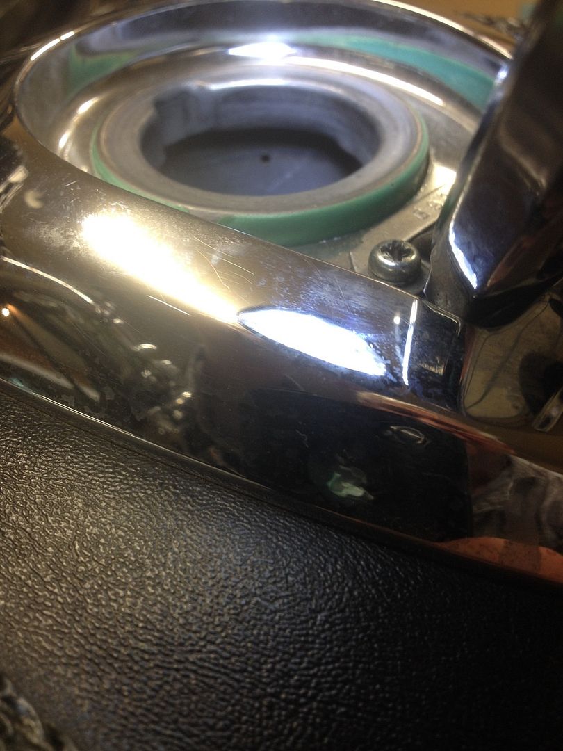

Ok,I looked for the hole in the filler neck and found nothing but some rust still there.Took a metal coathanger bent the tip and used it to scrape away the rust and still can't find the hole {don't even go there on that one} used a dentist mirror to look where the pipe from the back comes into the neck and tried somemore rust removal and still can't find it.The pipe comes into the neck at the 6  o'clock position Right????????.How large is the opening?HELP!!!!!!!

The hole you are looking for is at the 1:30 position, not 6 o'clock.  It is no more than 1/4" below the lip of the cap flange...
