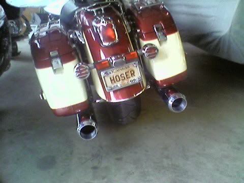

Another option is to go with a set of truck stacks.  You can slide them over the muffler and then you do away with the clamps altogether.  You will need to cut a notch in the back for the stock mounting bolts but a cut-off wheel or jig saw will handle that nicely.
One offering... http://www.airflo.com/valkyrie.html
Information on the installation process... http://www.valkyrieriders.com/shoptalk/truckstackinstall.htm
I finished mine off with a set of Grumpy's tips...really finished the ends.  Monica put slash cuts on her bike.
Joe
Cheers for the links this is probably they way I might go.
Just measured up mine and 32" will probably bring me back to the back edge of the bags

Quietman,
 Check out this post from Grumpy...  http://www.valkyrieforum.com/bbs/index.php/topic,79995.0.html
Grumpy (aka Bill) is a metal fabricator who makes finishing tips for truck stacks.  Since he no longer has his website available, I tried to find a few pictures of bikes with his tips installed.
I would contact Bill via email (bgurneysr@verizon.net) for a better product listing and prices.
Joe
