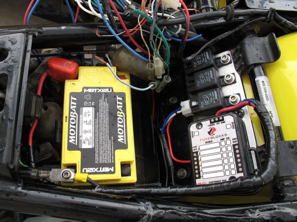

« Reply #7 on: August 17, 2015, 10:21:12 PM »
Not completed yet in this pic, but you get the idea.
One main connection to the battery, trigger fed from the stock "switched" connection under the right side cover.
Each connection to the Fuzeblock can be always live or switched.
(3) relays.  1 for driving lights, 1 for the air horn, and 1 for our electric heated vests/gloves. And (1) wrapped in a sock in the tool tray as a spare... Grin
I'll try to post a completed pic later.
