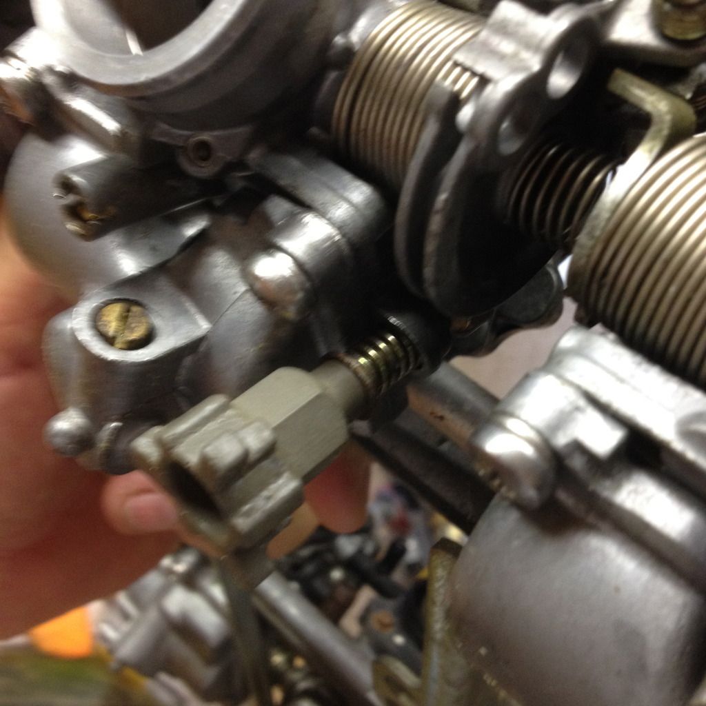

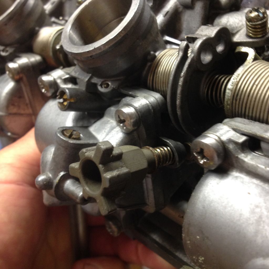

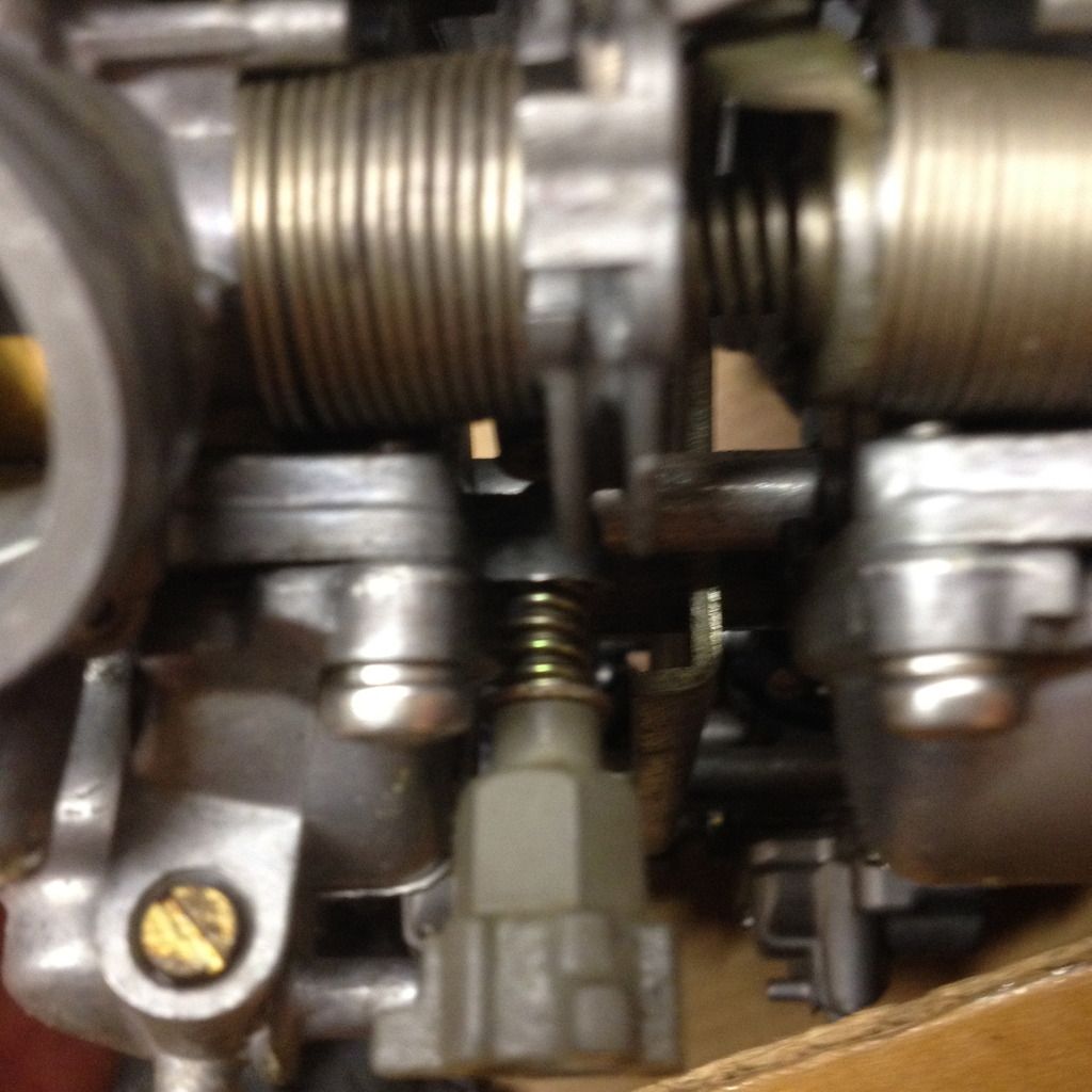

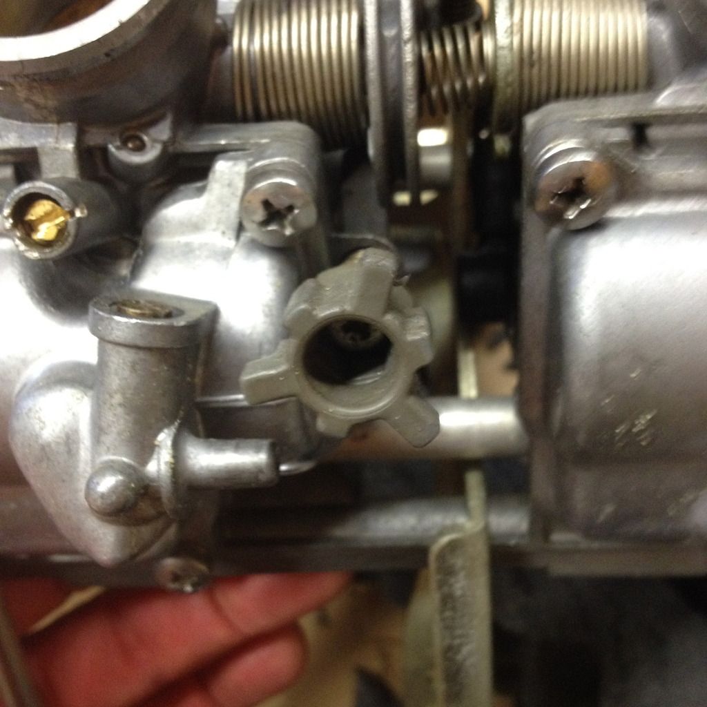

« Reply #6 on: August 18, 2015, 04:35:38 PM »
Hope this helps had a spare set
Dennis
« Reply #7 on: August 18, 2015, 04:44:33 PM »
Damn, with those pics I think I can install it here from my recliner.  Smiley
