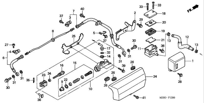

I am having a problem with the rear caliper should both piston come out when the brake pedal is pressed.and is the plastic cover on the rear res just a clip on don't want to break it if there is a trick to it.

I don't have my valk anymore but I think all resevoirs covers have small flathead screws holding them on.
Someone will correct me if I'm wrong about the rear brake one.

Your right here is a picture look at the res. cover #18.

The plastic cover on the rear brake fluid reservoir is not just a clip on.
If your brakes are sticking like that, you need to remove the calipers,
pop out the pistons, clean it all up and put it back together with new seals...
