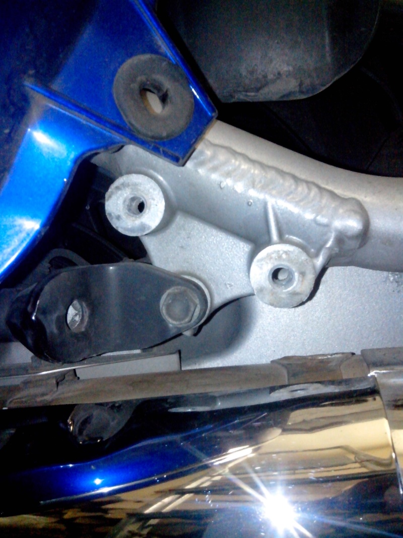

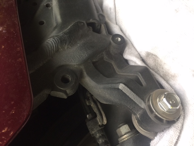

We should ask the F6B or GW owners because on the Valk, the chassis looks like this
and it should be OK I believe  Cool
or not, if this is right  and the #16, 84130-MCA-S40 looks like this :

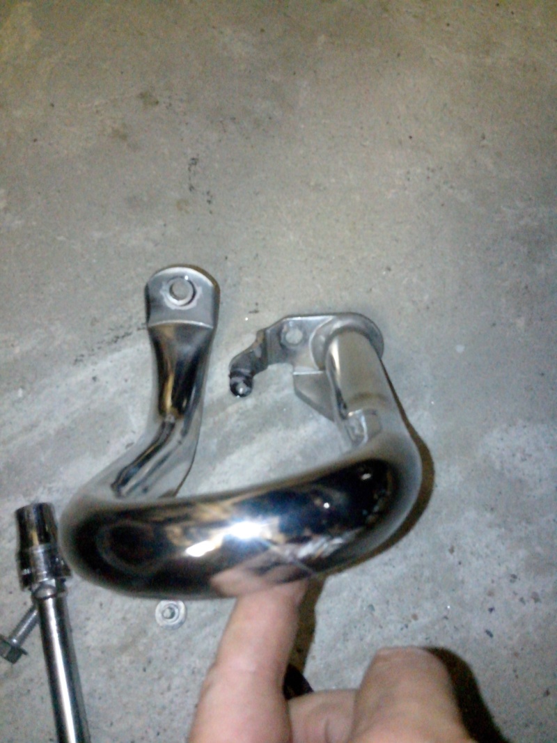

Someone posted the pix of his GW on the french forum and it looks like this :
I'll check tomorrow if the distance between  the two holes (6 cm/2.36 in) is the same on my Valk and I'll let you know.

« Reply #8 on: September 29, 2015, 02:19:59 PM »
I give up ! The holes a just a little too distant (8 mm) and even the holes to fix the pegs are 7 mm too far. Most of all, the crashbars are really large (in order to protect the bags of the Wing or the F6B) and the bike becomes as large as the Wing without the advantages of the bags  uglystupid2

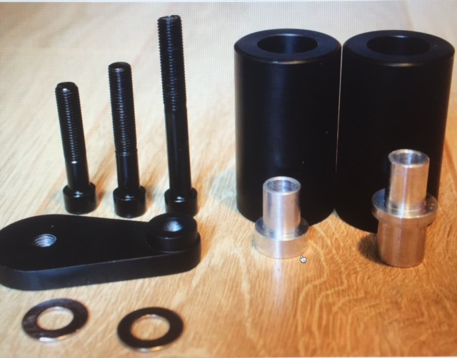

In fact, I gave up the Honda crash bars but I don't give up the idea. I need something between 6 or 10 cm (0.19/0.32 in) and I'm wondering if these could fit :
goldstar903
Posts: 425
« Reply #11 on: October 02, 2015, 04:32:54 PM »
If those are the black barrel crash bars that I have on my ZX-10R, then they are 3 1/8" long by themselves.
