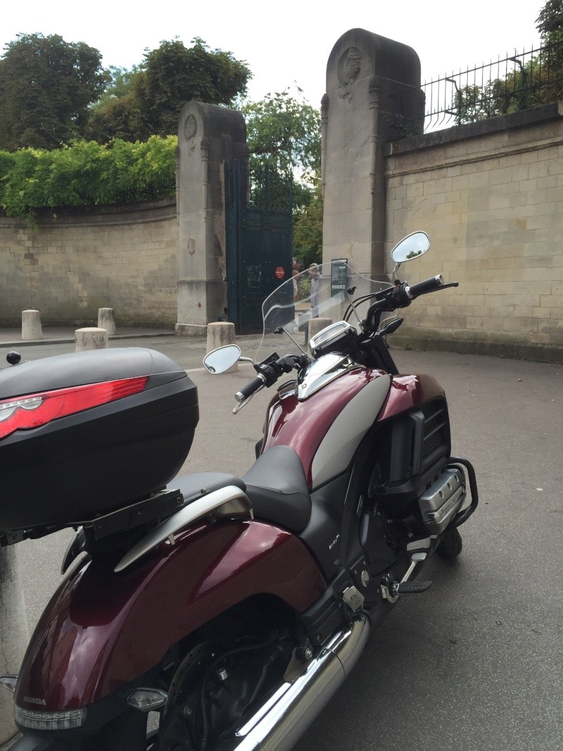

ledany
 Have any pics of your bike in Paris, could you post please?
This one at the entrance of Père-Lachaise graveyard :

« Reply #14 on: September 28, 2015, 09:51:05 AM »
ledany
Ledany
 Thanks very much, my wife and I loved the pic.  cooldude cooldude
I noticed a grey strip between the tank and the radiator pod is that factory? I have not seen another bike with them.

@Robert : hell no, it's not factory, it's me !  Grin
3M is the secret, so easy to fix (use a transparent sheet you tape on the tank, draw the contour, cut, report on the 3M sheet, be smart - unlike me - because the left side is different from the right side  2funny, cut and that's it !).
It costs less than 10 $ and I think the bike looks more classy, more like a Guzzi California III than a HD  crazy2 (that's why I chose a red Valk instead of a black one, no offense Jerry  Wink).
I wanted to upgrade the bike this way because the tank looks thinner AND you avoid the knee scratches.
Long ago I ordered a mirror 3M sheet but I don't know where I've put it in my personal mess  Roll Eyes

Nice job on the 3m I know that stuff well, with the pic you could not see it takes the curves of the tank, it looks like its not on the tank but a cover. It looks very good nice job. cooldude cooldude
Love the pics start a riding thread and post on there. Thanks by the way would love to see more. My bike is red too so now I know what it would look like in Paris.  Grin
