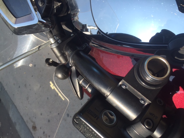

My Ram Mount on which I fix a TomTom 125 GPS (2nd hand, 100 €) in a waterproof case, much cheaper than a bike GPS (400 $).

I used the ram mount and have a Honda wind shield. Took the shield off drilled 2 holes in center of cross bracket for windshield. The base mount has oblong holes in it for included u bolts . The spread on the holes work perfict on the flat cross bracket and holds the phone or gps just above the spedo head directly in line of sight. Used the straight bolts came with the setup. Mounted a direct wired cig liter USB accessory to handlebar on right of spedo to plug phone or GPS in. I did do the wind shield mod to jack the bottom of the windshield out to match the angle of the forks. So I have a lot more room between the spedo and shield but I test fit it before the mode and would have worked either way. I used the 1 1\2 inch u bolt link as described in another thread here to make that mod which worked great to eliminate the buffeting experienced with Honda shield. All is good. Ready to ride.
