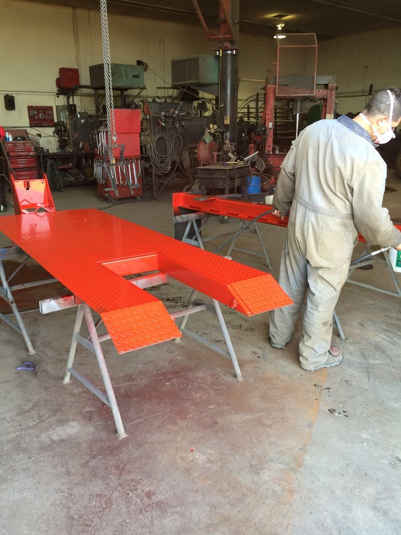

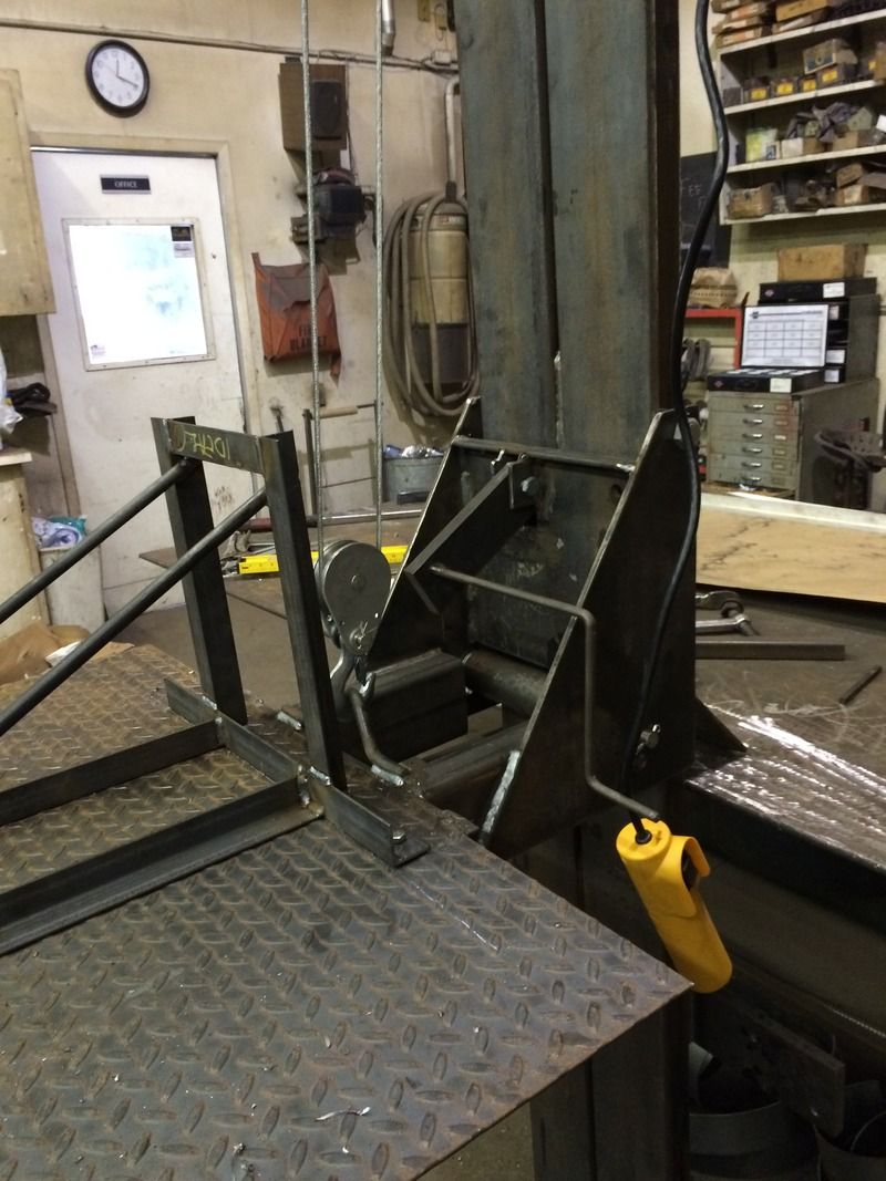

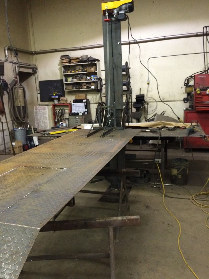

If it wasn't really clear what I was building, here it is.  Almost done, just doing paint now.
Raises by electric winch, has a safety on it so it will only lower with the safety bar raised, pins at maintenance and storage heights, has removable piece at the back and removable chock on the front so wheels can be easily removed.  It will be anchored to the floor and wall with 8 1/2" wedge anchor bolts, 4 on the floor and 4 on the wall(I have 3 feet of concrete up the wall in my garage).
Made for the tire width, anchor points, wheelbase, etc of the Valkyrie.

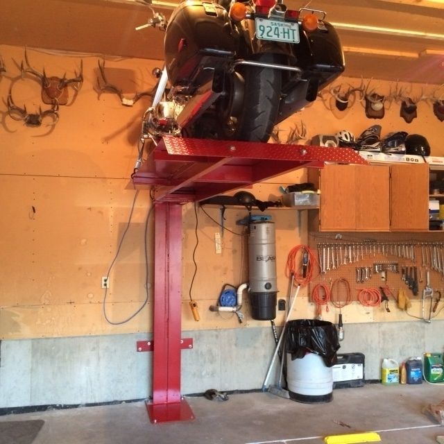

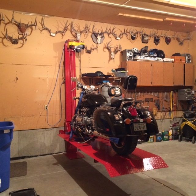

« Reply #16 on: October 25, 2015, 08:05:37 PM »
All finished and installed. Works good.

Posts: 31095
« Reply #18 on: October 25, 2015, 09:54:13 PM »
Very nice indeed!!
That's almost big enough for a mother-in-law bed.   Grin

Posts: 10652
« Reply #23 on: October 26, 2015, 01:45:40 PM »
Looks scary.  Shocked I wont walk under car lifts any more since I've seen what they do to people when vehicles fall.  Shocked
Beardo
Posts: 1247
Regina, Saskatchewan Canada
« Reply #24 on: October 26, 2015, 03:54:52 PM »
It's quite stable. When we were building it, we just had it tack welded to that table behind it. We got it all built and I used it to lift myself up to drill the top safety pin hole. My brother in law reminded me it was only tacked...I lowered it down rather quickly.  I suspect 8 bolts with a sheer/tension strength of 8000lbs each would be considerably stronger.

So I found a nice little bike jack that works perfect with the homemade lift. Used it with a wood lift adapter, it works great, a couple turns of the ratchet to lift or lower it.  Nice and smooth and very stable, left the front of the bike tied into the lift.
The lift worked great to do the rear end service.  Also did the shifter seal and it was nice to be able to work at eye level.

« Reply #34 on: February 09, 2016, 08:07:05 PM »
Is there more to the attachment of the upright to the wall and floor than is visible from this photo?
Is there an attachment point higher up?
It seems to me to have a lot of leverage on the wall and I don't trust light concrete block walls.
The lift is a really nice piece of work.
Dan
Machinery has a mysterious soul and a mind of its own.
Beardo
Posts: 1247
« Reply #35 on: February 09, 2016, 09:27:49 PM »
It's 4 bolts on the floor and 4 on the wall, what you see in the pictures. That isn't a concrete block wall, that wall is solid concrete and it's thick. The bolts go about 6" into it. The bolts are rated to 8000lbs sheer/tension strength each. I don't believe it's going anywhere. And the vertical part is very heavily built, when the bike is at the top, it maybe flexes a quarter of an inch away from the wall. I thought about putting another support further up, but I don't think it's necessary.
When I have it up all the way for winter storage, I attach a heavy duty ratchet strap to the rear of it and up to a hook we made that attaches to the ceiling, just to support the back end and eliminate any of the torque/weight when it's at the high point. I don't think even that is necessary, but just gives piece of mind.
