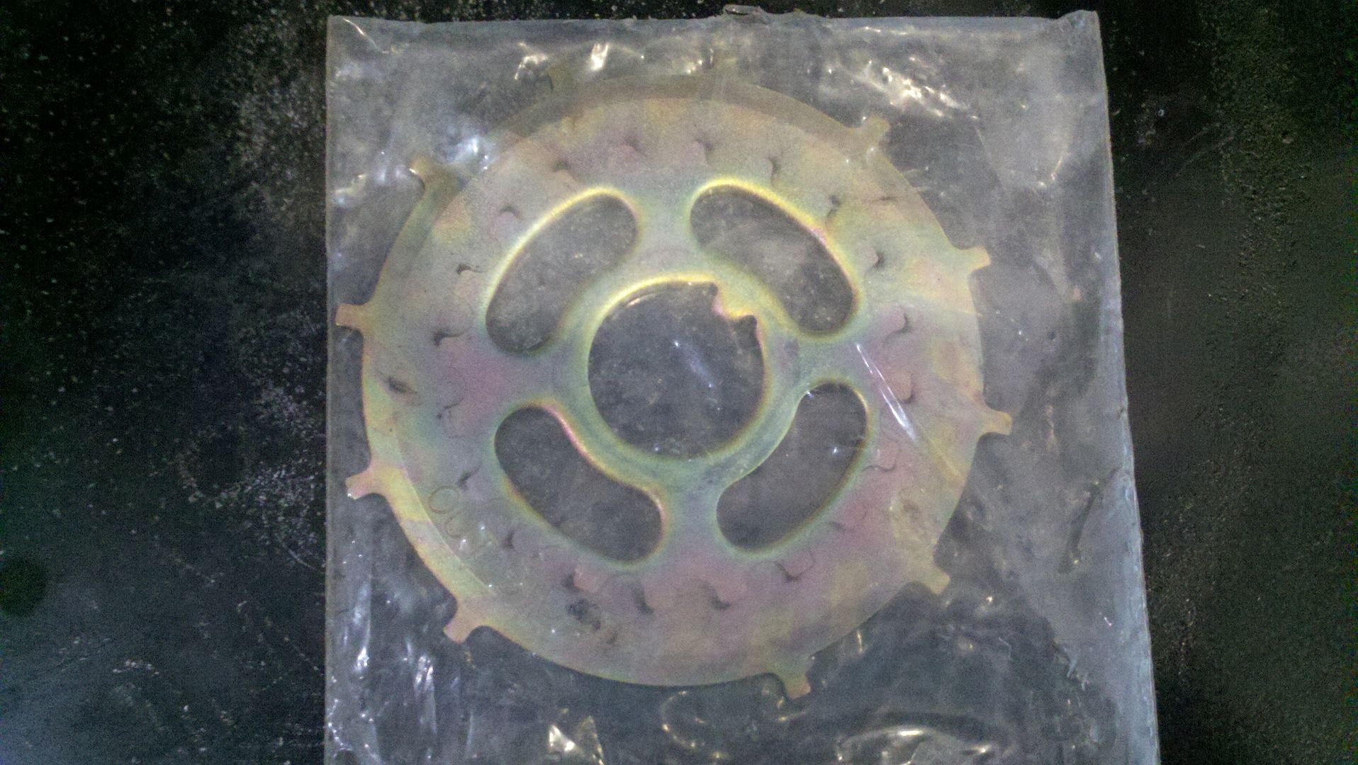

Author Topic: Is this the factory trigger wheel? Photo.  (Read 1028 times)
« on: October 26, 2015, 05:30:22 AM »
Posts: 13661
« Reply #1 on: October 26, 2015, 06:37:52 AM »
looks like it with the squared off trigger points. should be some #s printed on other side. if u are buying it from somewhere make sure its not from a GL1500 Goldwing engine, that uses a zero advance at idle whereas the valkyrie is 3.5 degrees.
« Reply #2 on: October 26, 2015, 07:14:17 AM »
It came with a box o' bits when I bought my bike.
I also have some carb springs.
I'm guessing a previous owner - not the one I bought the bike from - did some mods.
Also desmogged.
