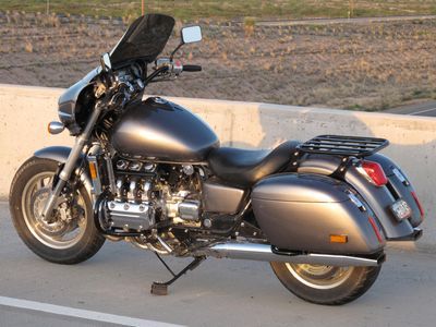

This is what I did with an 1100 trunk rack/mount, probably not what you're looking for. I also set it up to mount the associated trunk if desired, but by itself makes a rather large luggage rack. Had to weld a couple "L" shaped brackets to the bottom, then drilled them to let me bolt in place where the sissy bar/backrest goes. The front length was cut off and I found some truck(semi tractor) mirror extensions that support the front real solid. A couple of bracket off the original hardware comes with a plate nut so I cut/shaped them and left them permanently mounted on the front fender bolts. To remove is only three small bolts each side, notice I also set it up so it sits over the rear wheel instead of hanging out back beyond the rear fender like an I/S. The trunk just snaps in place and locks, easy on/off.

Ebay!  Got the mount and two trunks off there, made one good trunk from two and also gave me some spare parts for it. I added the lid rack and handle. On the inside I added a restraining cable on each side, nonexistent on the OEM version. Then sent for a bag made to fit in that particular trunk. My friend that did the leather for the rest of the bike covered the backrest on the trunk to match. Just in case I ever want to change the mount so I can carry a passenger.....however unlikely that may be. The two cross buttons on either side are where little bags used to mount, something I had no use for.

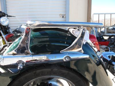

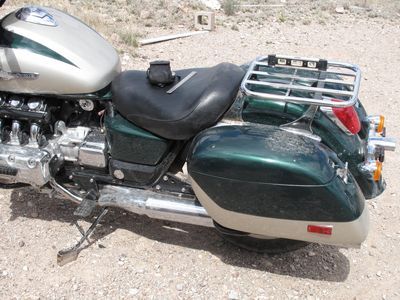

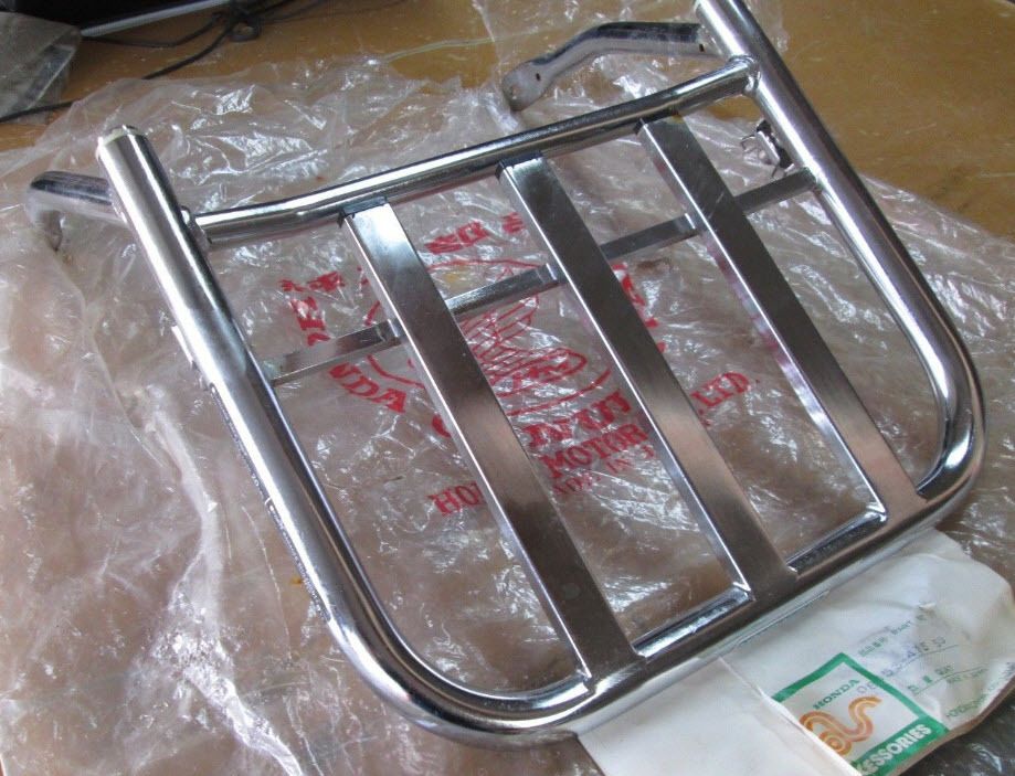

Get a couple used Hondaline luggage racks from ebay.  Be patient, as dealers think these are gold.  You want to wait until you find some guy cleaning out his old parts.  I paid $35 for 1 and $50 for the other.  The one in the pic is on ebay now - he wants $150!  They sold almost identical versions of these to fit many bikes in the mid 80's.  Brackets don't matter, as you are going to whack em off:
Get an extra pair of Valk luggage rack ears.  Trim em a bit, spot weld , then start playing with angles.

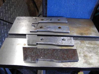

Get some 1/8" mild steel stock and start fabbing some brackets to bolt the luggage rack to the ears.  These pieces get welded onto the luggage rack - you need 4 total:
Once you know how long you want it, trim to the right length, and weld the pair of luggage racks together - basically butt welds.  I made up solid inserts to mate the two halves together.  The bar inserts were rectangular, about 1/2" x 1/4" x 3".  The perimeter inserts were some steel tubing that I had to grind down to the right diameter.  I tacked it all in place, then took to a welding buddy.  The key thing is to not let it get too hot - don't want it to warp.  Once we had it welded, took it to another guy who does brazing body work, and he filled/brazed/sanded until rectangular tubes were again rectangular, and round tubes were again round.  In this pic you can see the 1" x 1/8" flat bar I tacked on to span the rear ears and make a mounting point.  Note that the rectangular tubing in the Hondaline rack is really light gauge.
Weld on the (4) tabs you made earlier, off to the powder coater, and Bobs your Uncle.
Just got off of work, but I can get a close-up later if you want.  It's really strong.  I have used it to carry a Valk rear wheel AND a tire from home to the local Indy shop to mount.  It also carries a couple cases of Millers just fine...  But you have to use good bungies... cooldude

No, but almost, so I had to change the lids to operate as I/S lids. Already had that kind of lid installed so it was just a matter of changing the hinges and cables. I don't have the rack installed all the time, only when I want to use it for carrying something or for trips using the trunk. Six small bolts and it on/off in just a few minutes. When I first got the trunk mount, I cut everything off underneath the mount. Then positioned it where I wanted it and marked how much length to remove. It's very solid, I've carried stuff much heavier than a full trunk weighs. With the weight over the rear axle instead of hanging out back, the bike handles great. I'm guessing that's one of the characteristics Britman is looking for.
