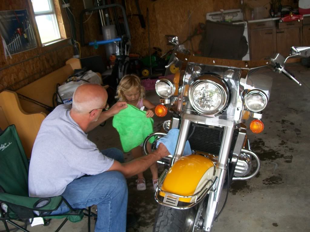

« Reply #2 on: September 09, 2009, 02:37:47 PM »
I don't have a good close-up shot, but here is my bike with that combo.
