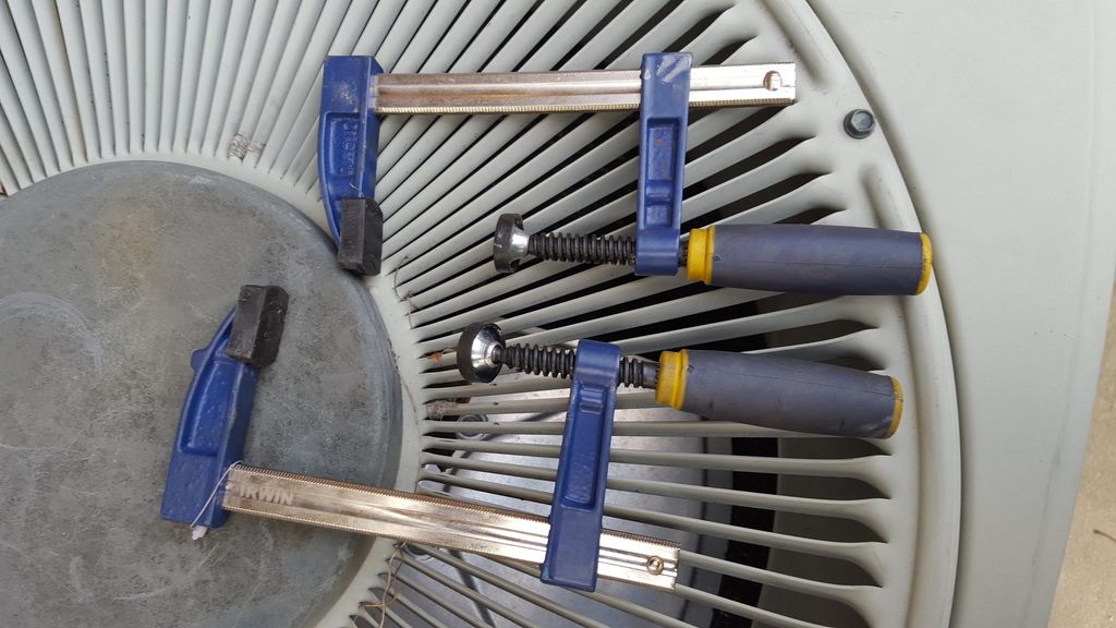

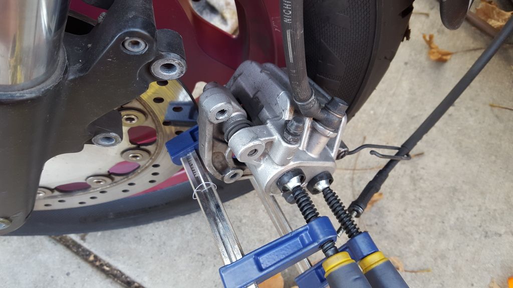

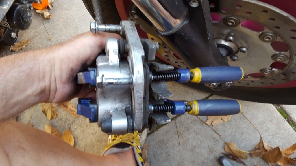

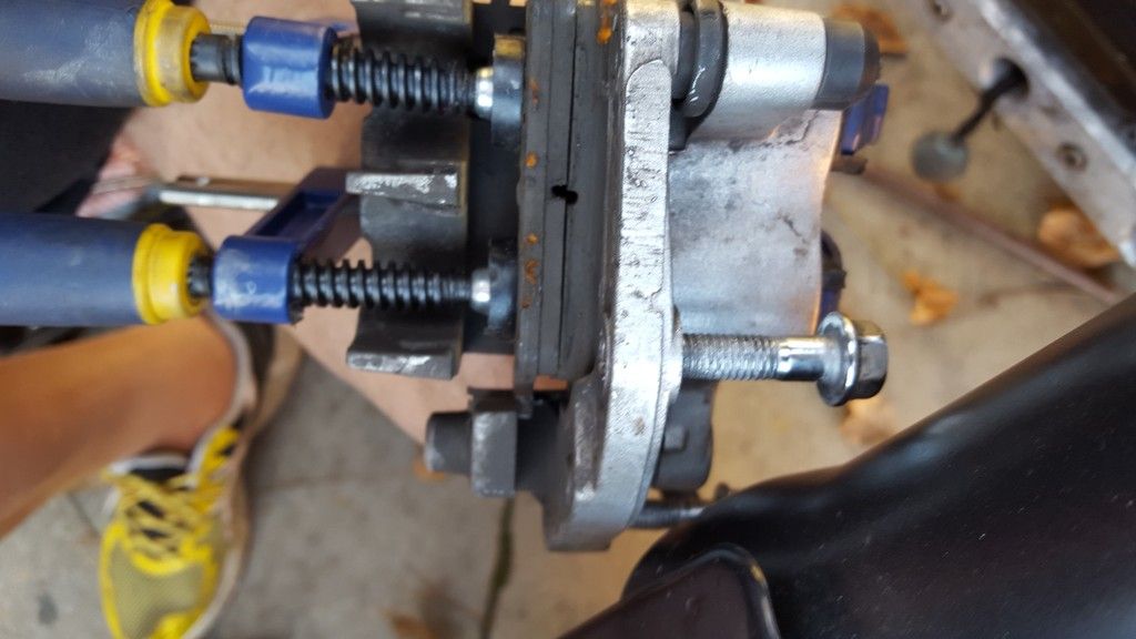

At times I've found myself needing a clamp to retract the brake caliper pistons and I did not want to find myself pushing one piston without having the other still protruding or worse moving out while trying to push the other in.
Well I/ve found the perfectly sized (and non-marring) clamps at LOWES. The jaws have plastic covers and they are small (and cheap) enough to be a dedicated VALKYRIE ONLY TOOL! I bought a pair for less than $10.00. Check out the photos below.

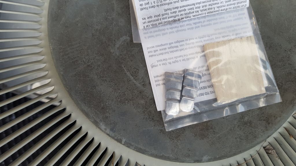

I've also found that some axle pinch bolts have distorted the lower fork castings (several others bikes).
I have used screwdrivers inserted into the bottom of those fork castings, but......screwdrivers are to be used to remove screws, not wedges!
I found that a pair of "Hammer Handle Wedges" to be a cheap (<$2.00) and dedicated tools.
