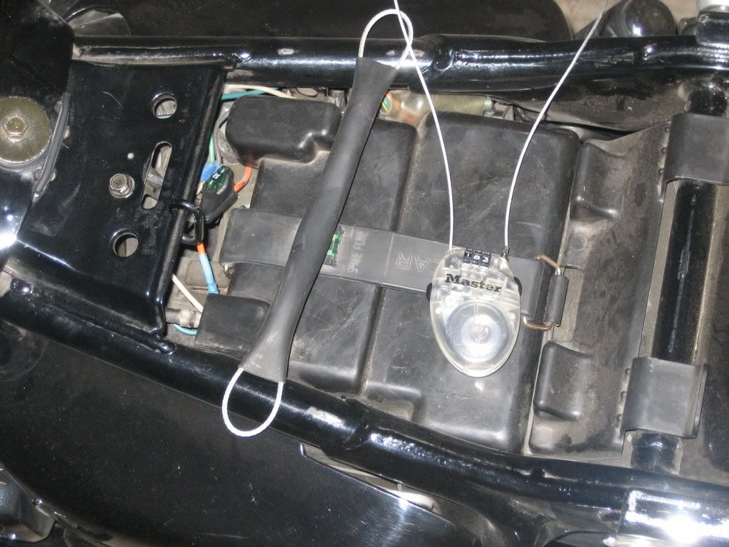

You need to provide more details or pictures.  If you have a helmet lock on a Valkyrie it is not stock.  The only helmet lock I know of that Honda provided is the wire loop on the left side of the photo (not the Master cable lock).
EDIT AFTER READING SUBSEQUENT POSTS:  Did not realize the Interstate had those.  I stand corrected.
