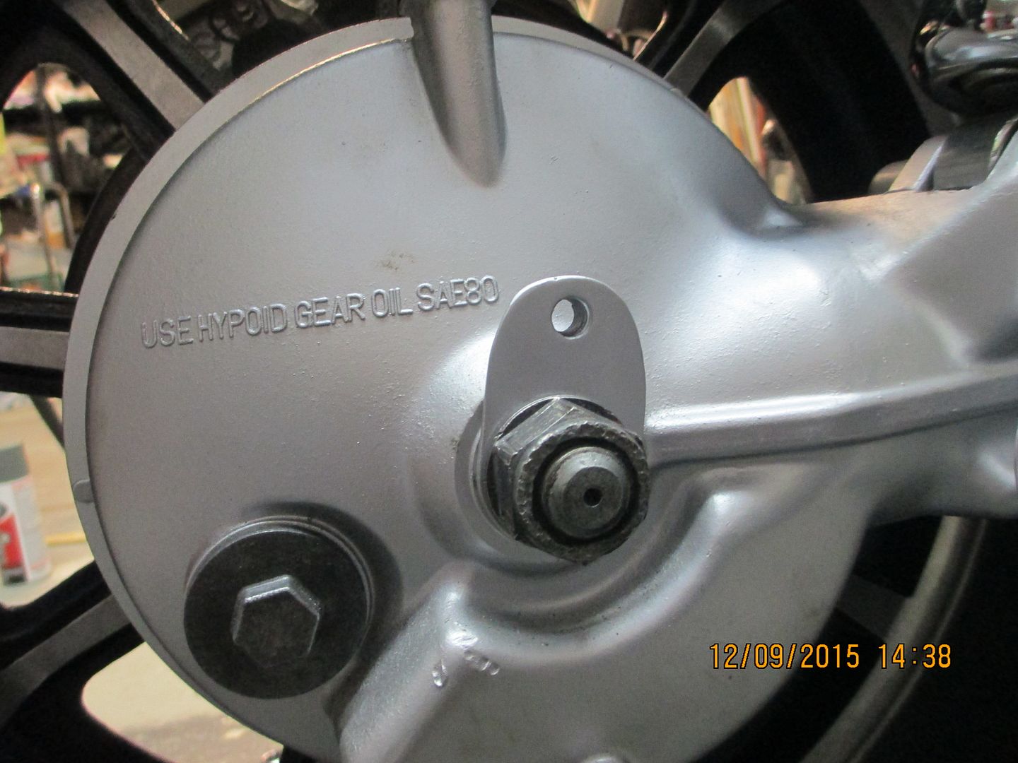

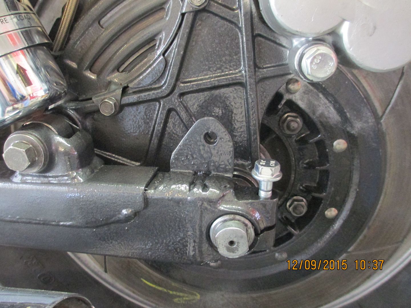

Just need to pick up the flat stock I'll be using to make the braces. I think it will work out fine. Haven't decided if I want to rivet or bolt(button heads) the braces to the fender. I only have a pop rivet tool but don't feel that would really be stout enough. Any thoughts, suggestions?
Left side bracket, nut welded on the back side. Also showing the new axle without the snapped thread tap in it.
Welded a nut on the backside for the right side bracket.
Full view of the right side mount. The refill plug is kinda ugly, guess I'll give it a shot of paint as well.

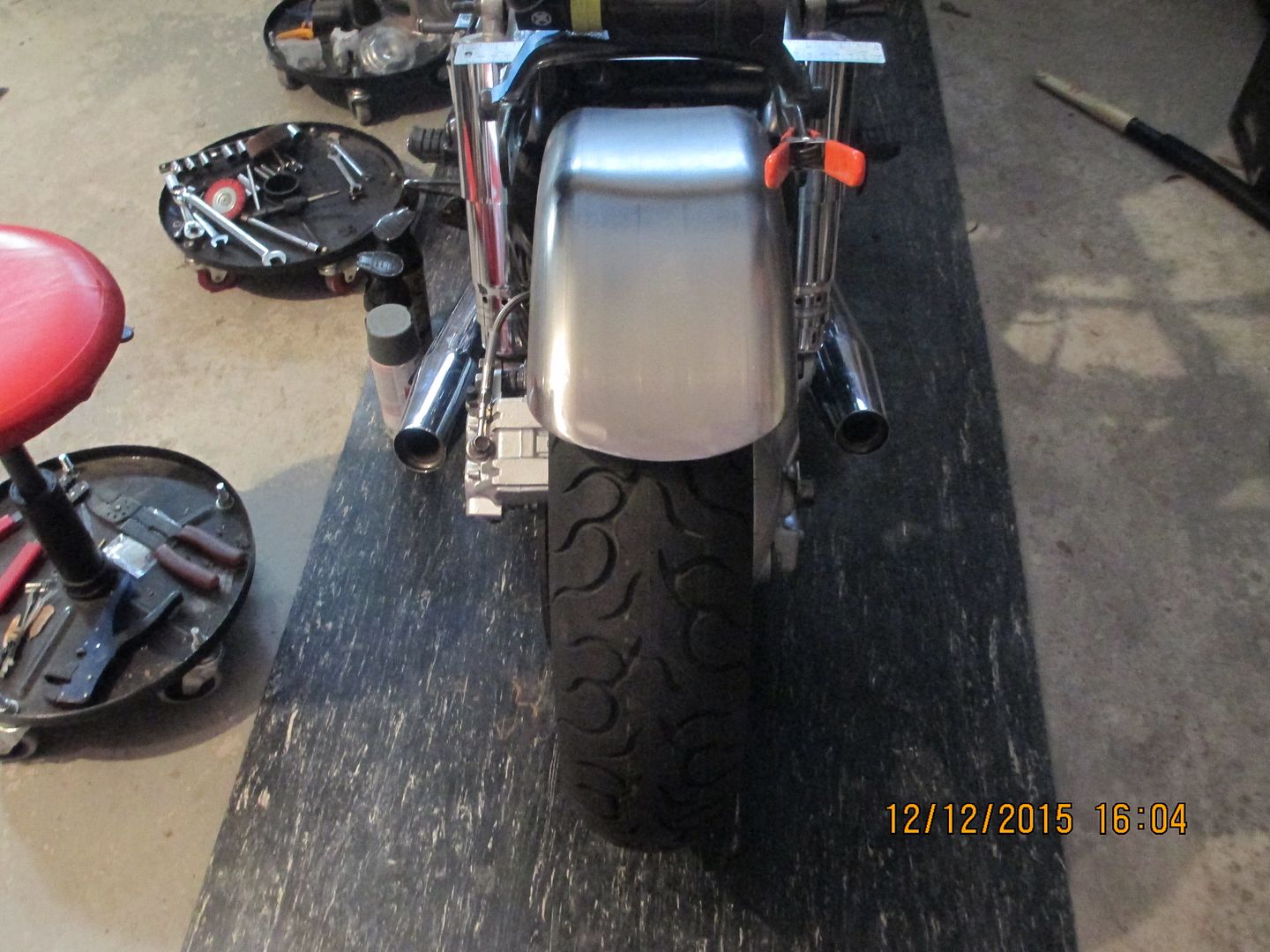

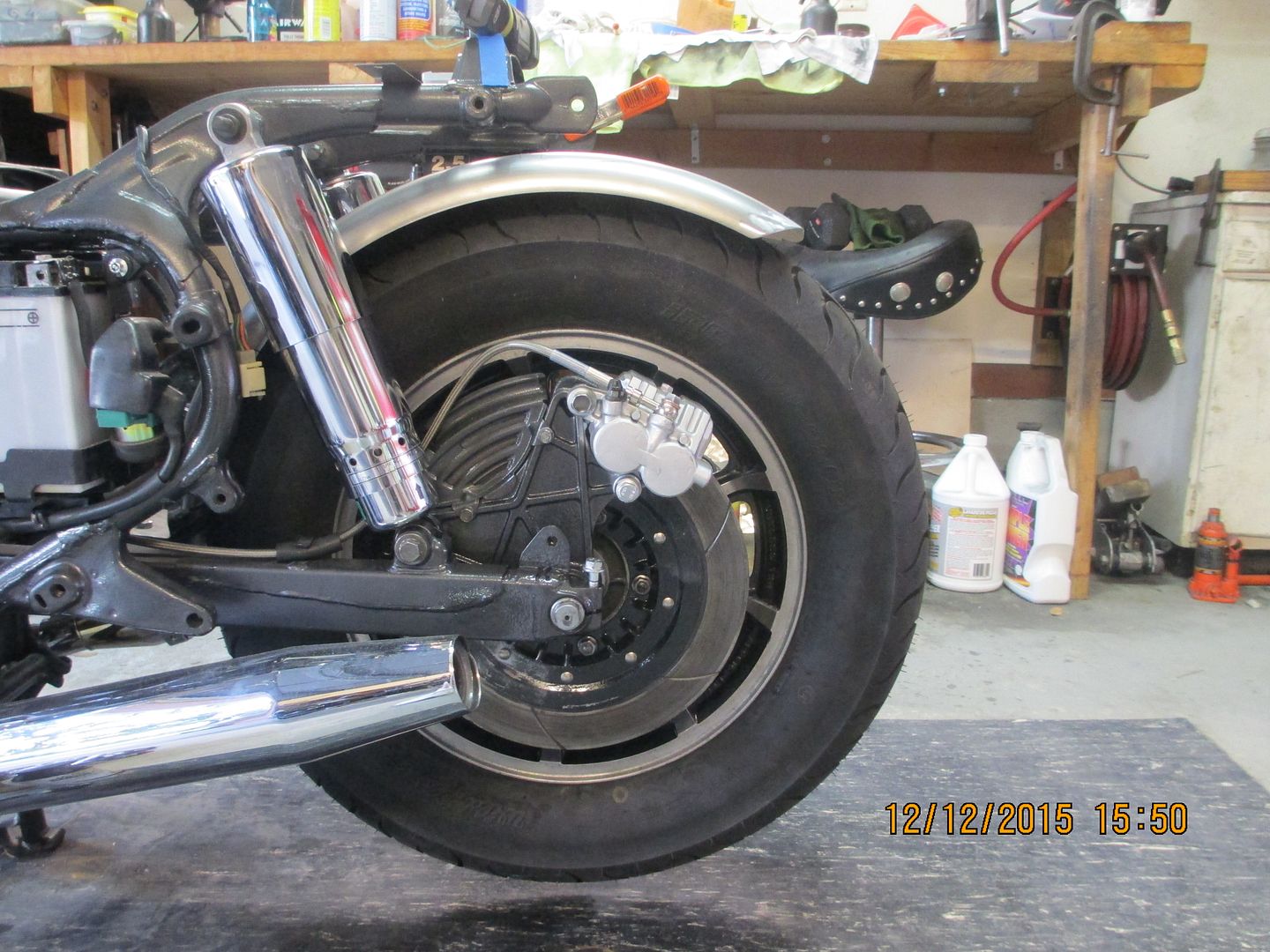

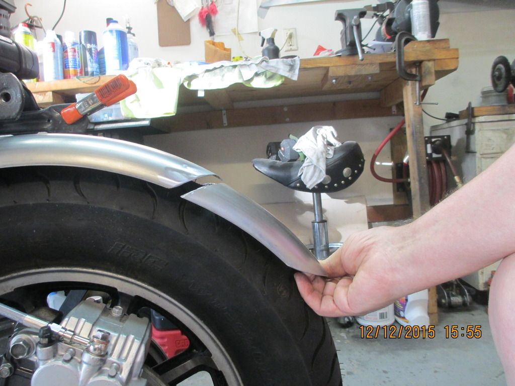

Cut six inches off the back end of the fender, I think it looks better this way.
When I get the brace material this week, I'll be able to center the fender before making it a solid mount.
