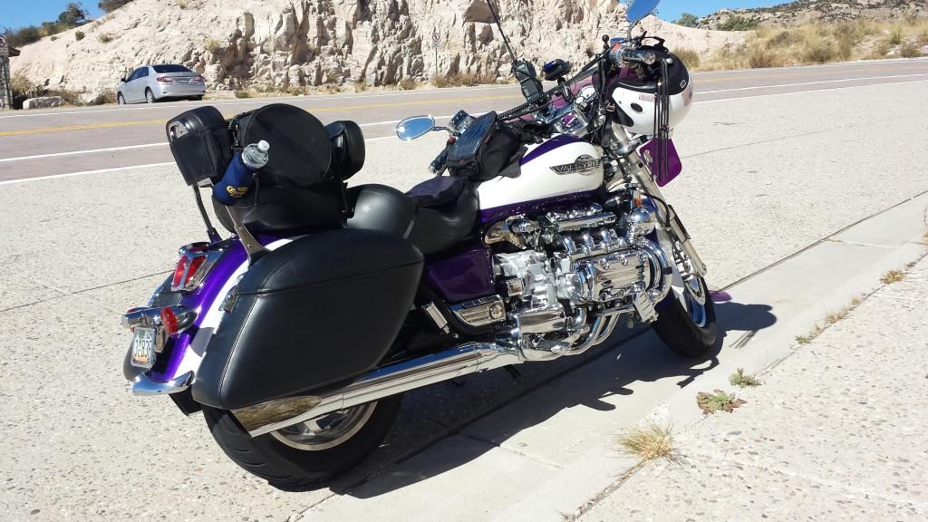

To get the fit and alignment I was looking for with the Tsukayu Jumbo Strongs, I used washers instead of spacers,, two in the front, and five in the rear.  No problem with the Z mount clearance to the caliper. Notice I have the older Jumbo Strong's with the side flip lid as opposed to the flip to the front lid on the newer ones.
