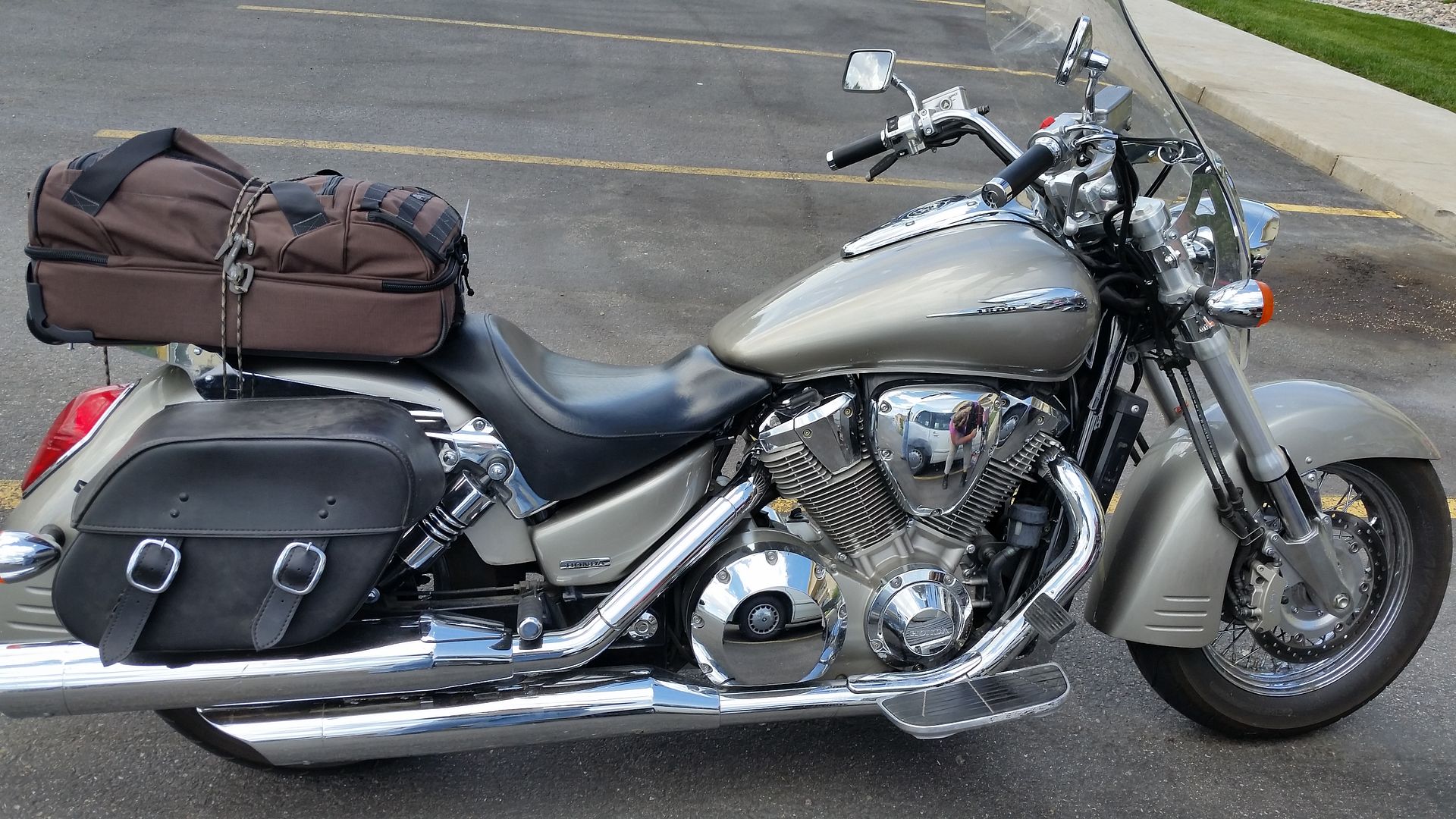

« Reply #5 on: January 31, 2016, 09:56:26 AM »
Here is how I did it on a VTX R ...
The carry on bag is on a rack, the saddles are on easy brackets. 2 days, 700 miles, no problms.
