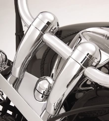

« on: September 14, 2009, 02:10:46 PM »
I see discussion about raising the handlebars on a Valkyrie.  If I understand correctly you can raise them a couple inches without requiring longer cables.  Is it correct to assume that raising the handlebars creates a more comfortable riding position for taller riders.  I'm 6'5" and wondering if this might be worth doing.  If so, what are the best parts to do it with?  If anyone has risers they want to get rid of I may be interested.  TIA

« Reply #1 on: September 14, 2009, 02:21:36 PM »
I would think that raising them would be a matter of comfort preference.
Adding additional pull back is often done to accomodate the vertically challenged. I have about a 1 1/2" rise with 1 1/2" pull back as I do not have simian arms.
Riding comfort is actually more than just comfort-it gives you better control and can help with fatigue on longer rides. Seating position is equally important for the same reason.
At 6' 5" you would benefit from a higher rise as you would not feel like you are slumped over the bike.
Doubt if you need any additional pull back unless you will be steering from the passenger seat.
There will be lots of info coming on what risers will suit you.

« Reply #3 on: September 14, 2009, 03:53:10 PM »
being 6-5 maybe you don't need pullback risers....try loosening the handlebar clamp and rotate the bar up a bit

« Reply #4 on: September 14, 2009, 05:07:27 PM »
I'm 6'2" with a normal sleeve length for my height. I installed longer risers mostly to put the handlebars in a more comfortable position for my wrists. The pullback and handlebar
position are very individual choices but I can say that often a small change can make a big diference.

« Reply #6 on: January 18, 2011, 11:56:12 PM »
I put 4" Monster Risers (I think they were called that) on my 97.   I'm 6', and love the more laid back position it gives me.
It really depends on how you like to ride, I don't like to lean forward much, but ride in a mucvh more upright position;  personal pref really.

« Reply #7 on: January 19, 2011, 03:08:29 AM »
I put these on from HDL. It really helped for me. I would get severe upper back pain, between my shoulder blades after about 1-2 hours. These eliminated that for me. My pain was aggravated while riding. It was from a previous injury. That slight differance in riding position was the ticket for me. I probably wouldn't have looked into this, if it wasn't for my pain. Now, I think it would be more comfortable for any Valk rider. Wink
http://www.directlineparts.com/product.asp?pid=468&str=2

« Reply #8 on: January 19, 2011, 06:33:39 AM »
I have 2 Valks, both with the HD deuce risers.  Really like them. Just need to drill the bolt holes out slightly to take the bigger bolt.  But, will be OK if you want to go back to OEM. May need to reroute the cables.

« Reply #9 on: January 19, 2011, 07:20:00 AM »
I agree with others that rise, pullback, and bar shape are very much personal preference.  At your height, I can imagine addressing rise and/or shape before pullback, unless, you are like one of my buddies who likes to ride with his elbows very close to his ribs.  I changed my bars to stock VTX1800C to address wrist and elbow fatigue.  However, that change cost several inches of pullback.  So, I had to change risers to make up for it.
I wound up with HD-compatible risers that, like the Deuce / copy risers, use a 1/2" thread.  The hole in the Valkyrie Top Bridge is slightly smaller at 12mm.  Some have successfully drilled the Top Bridge to accommodate the HD risers.  I've never heard of anyone screwing that up, but why would someone broadcast their failure/mistake???  I chose not to make that permanent modification.  Baron Custom Accessories makes an adapter with 1/2" threads on the top for the risers and 12mm on bottom for the Top Bridge.
About $20.00 to leave your Top Bridge unmolested.  IMO, Priceless.   cooldude

« Reply #10 on: January 19, 2011, 08:15:53 AM »
Sit on you bike and take the time to pay attention to where your hands fall naturally, so that you don't feel any tension between your shoulders. If you have to reach front for the handles, then you need risers with pull back. Like others said, sometime, just loosening the bars and rotating them will be enough.
I used to own an old Goldwing and tried rotating the bars down a little. Man! it made a whole world of difference in the way the bike handled and in riding comfort!

« Reply #14 on: January 19, 2011, 08:21:02 PM »
For what its worth, I put Deuce risers on my wife's '98 Tourer and didn't have to drill the triple tree.  I ordered them from J&P.  When I called the order in, the girl on the phone asked if they were for metric or standard.  I said metric and the ones that came were the same thread as the stock risers.  I've relayed this before and it was reported that on other orders, the person at J&P had never heard of metric Deuce risers, so, I guess it depends on who you talk to.

« Reply #17 on: January 20, 2011, 10:18:25 AM »
7 inch pullbacks are the max you can go without changing the cables.  You will have to reroute them behind the trees, and reverse the clips under the bar.  The Deuces are the way to go, they look good and really make a difference on a long trip.  Drilling the top holes is nothing, you just have a slight amount of material removal, and it wont keep you from going back to stock if you want.  Rerouting the cables is easy and there is no ill effects if you keep the kinks out.

« Reply #21 on: February 03, 2011, 08:45:55 AM »
Because for Valk they all go up and back, then sit on an angled triple tree, realize that HOW risers are measured is not standard.  That said:
Stock riser height is in the area of 3 1/8"
Most aftermarkets are around 4" (BBP/Show Chrome)
HDL sells in-house risers called 'Cycle-House' which are 4 1/4"
LaMonster/ Aeromachs are advertised as  4" pullback risers which raise the bars up 2"  and 1-1/2" closer to you from the stock location ,
