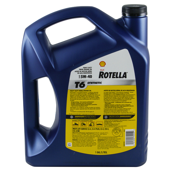

Shell Rotella 5W-40 Full Synthetic. Diesel Oil works better with a wet clutch, or so I've been told.

Shell Rotella T6.

Make sure that whatever oil you use the back of the container has nothing written in the bottom portion of the circle as shown on this container.

diesel oil is the same as overpriced motor cycle oil
http://www.valkyrieforum.com/bbs/index.php/topic,65911.0.html
http://www.lngpublishing.com/LNGmagazine/index.cfm
this months issue
http://viewer.zmags.com/publication/e9f4b3fd#/e9f4b3fd/1
see article Two-wheelers love oil too!
they have a pic of the new goldwing valkyrie as a bonus.
JASO spec'd motorcycle oil are basically the same specs as heavy-duty diesel oil standards.
JASO does not test oils, manufactures pay a fee to JASO and state their oil meets the specs.
see article, another grade for the heavy-duty upgrade?
even better diesel oils coming into the market much better wear protection and using a 10w30 for better mpg.
