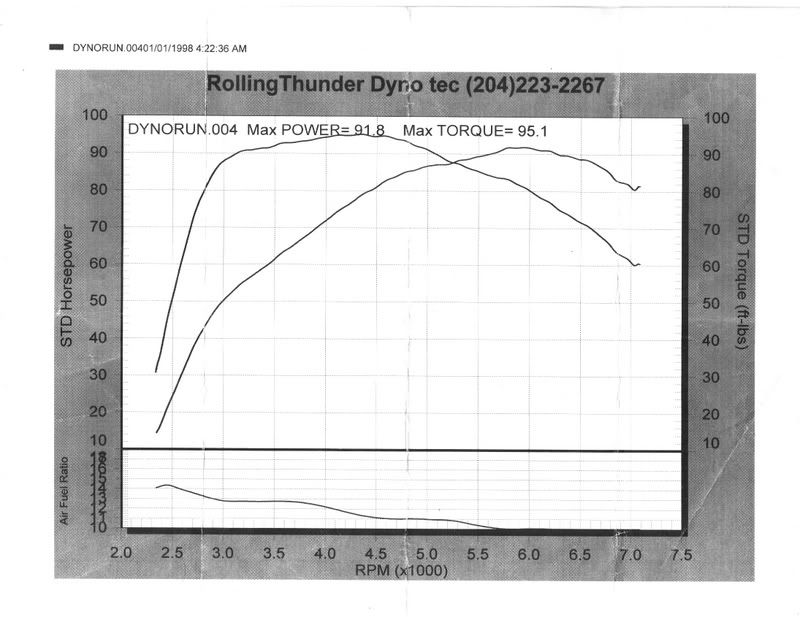

chrise2469
Posts: 295
Winnipeg Manitoba Canada
« Reply #6 on: September 17, 2009, 08:46:42 AM »
1998 standard
*K&N Air filter? Yes with prefilter
*Aftermarket exhaust? Brand? Yes, two brothers 6 into 6
*Exhaust mod? Glasspack? Cut Piggies? NA
*Dyna 3000?No, Stock ICM
*Jet Kit?No
*IS Springs?No
*Airbox modifications?No
*De-smog?No
*Jet size? Stock, 35 slow, 100 main
stock jets and needles (look how rich at 4000 Shocked)
