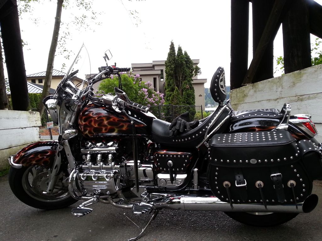

« Reply #10 on: April 06, 2016, 09:29:39 PM »
Here's a pic of the bike. It looks a little different now, but the paint is still the same.
I haven't decided if I'll repaint everything, or just the new fairing. Either way, I'm probably not going for the flames. The guy who did that job has closed up shop.

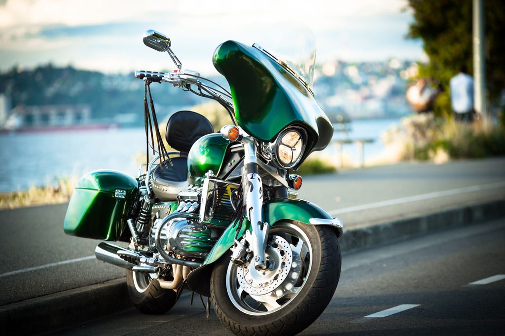

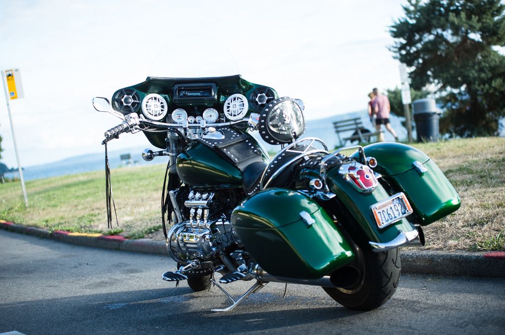

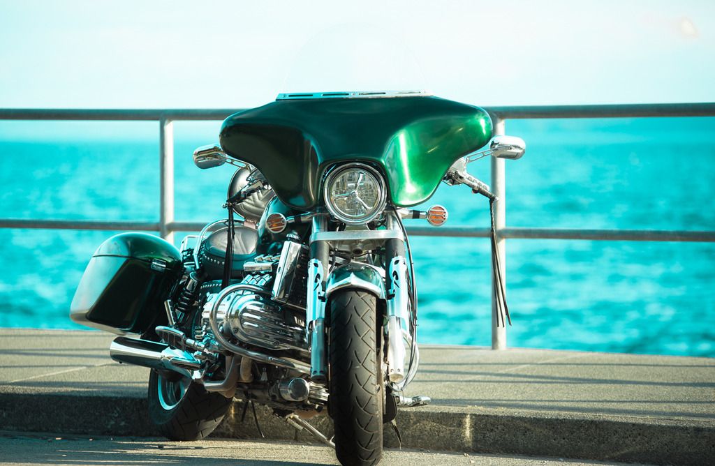

« Reply #29 on: July 12, 2016, 10:26:31 PM »
Well It's been a while, but I finally got all the parts in and painted!
I still need to buff and polish, so it's not that shiny yet, but it turned out OK... not perfect, but I can live with it.
I'm told I should let the clear coat sit for a week or two before buffing and polishing.
Looks pretty good from here.  cooldude

Looks good in the photo Lyonardo--what brand fairing is it?  I have been considering a Memphis bat wing.

Those speakers would drive me out of there, but your bike
looks GOOD  cooldude

I went with the Wide Open Customs fairing, because I didn't want to relocate all my gauges.
The Woody's fairing has some nice features, but there are requirements I didn't want. I want my handlebars free for a phone mount, stereo controls. etc...
The Memphis Shades batwing looks great from the front, but it's just a front shell. Plus, you can't add instruments or a stereo too it. I heard that it's the most popular fairing on any bike though, so I guess most people prefer it.

I don't love the look of those white speakers, but they had the best bass response of all the ones I tried. I might sell these if I can find something better.
But the sound is great, even on the freeway.
Not sure if listening to the news and audiobooks make me look like a geek, or just an old guy.
looks GOOD  cooldude

 I'd like to see a side shot of the bike with the front wheel straight to see how that fairing fits the bike,, I like the idea that you didn't need to relocate the guages, but would like to see the fit.
Nice job on the paint.

Look good on pics, you might wanna take off the white speaker covers and shoot them green too, just a suggestion
Lyonardo
Posts: 206
« Reply #39 on: July 14, 2016, 02:36:01 PM »
I didn't even consider that. But I think they're all one piece. No cover.
Still, if I can remove the cone, I just might paint the housing. Maybe black.
