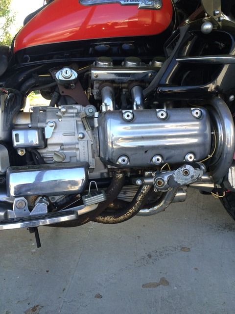

Has anyone used header wrap to wrap the headers? As you can see mine are very rusty thinking of using black wrap to cover them. If so any special prep? Thanks!

Wrapping will exacerbate the rusting. Painting or coating would be a better choice.

Another option is to paint them.  You can see in my signature picture below that I have painted mine.  I used VHT Flameproof Paint(click link) on mine.  I prepped the headers but scuffing with sandpaper.  It looks like yours will need that to knock as much of the rust you can get off.  Remove your pipes, paint them, let dry, place back on the bike, and follow the cure-out procedure listed on the can.  Mine has held up pretty good over the 2 years I painted them...yeah, they need a touch up...but they aren't all rusted.  coolsmiley

Before painting them after removing them, use some tinfoil dipped in vinegar on them along with elbow grease. Helps remove a lot of rust and might smooth them out a little before painting.

I painted mine with Rustoleum flat black high temp stove paint, about $5 or $6 at WalMart, almost three years ago now. They have not required touch up since. I sanded them as smooth as possible, and used several coats to fill in the pits and irregular surfaces left from the rust. Not sure if I did it all with one can, or had to get into a second one.

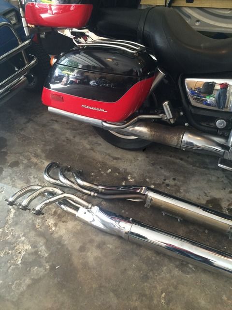

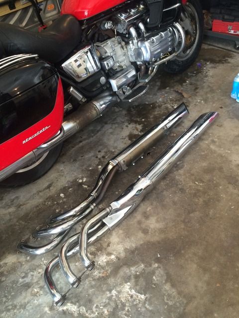

Scored some sweet pipes off Craigslist for $100 within 30 minutes from my house.
Decent chrome with light scratches. Takes care of both of my problems my rusty headers and the rusty exhaust shields.

« Reply #15 on: April 20, 2016, 05:38:31 PM »
I remember that thread posted. Looks nice beside your others.
Is that a slash cut on the end of the new ones?
Turns out my exhaust had the piggies cut off. Debating how to fix the problem. HATE that drone!
I think I'm going to start with adding on new piggies, 3/4" copper pipe. Make a jig, and try to extend them out the IS rear shield.
Chrome might be damaged. Also bent. So might end up adding on complete length truck stacks. Checked with the local wrecker, and can get used stacks for $50-$75 CAD. Might extend the piggies to the end of that, or look at adding on those 4" slip-on silencers.
I like the look of the slash cut, just wondering what direction to point them in? Waiting on the picture with the pipes on the bike.
