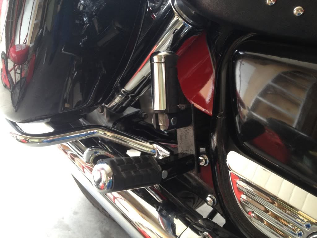

I used a piece of steel flat bar to move the mounting location of the footpegs higher.  Later I found some Interstate passenger footpegs to mount in the original location.  Because they stick out farther than my Tourer pegs, they are usable with the higher pegs folded up.

I too have a short wife and cobra passenger floorboards. Here is what I did. The floorboards mount with one bolt and utilizes a pin and dimple to lock it into a horizontal position.
You can raise the floorboards about an inch by simply rotating the front of the floorboards up. This will require you to drill a new dimple in each mount to lock it into the new inclined position. Obviously the original dimple remains so that the floorboard can be put back into the horizontal position.
Heads up! The pin & dimple location is different on each mount. Take your time when figuring out what angle and where to drill the new dimple.
My wife now can reach the floorboards and likes that they are angled towards her so she can push against them to make adjustments while in the saddle.
Hope this helps and good luck.

In this picture you can see the rotated floor boards

Great idea!  Does her feet tend to slip down at that angle? Ima gonna try it. Thanks   cooldude
I always tell my passengers to not let their heels hit the exhaust and it hasn't been an issue. I don't have mine angled that much, and the rubber on the floorboards offers enough grip where slipping doesn't happen.
Yup, free and easy mod. Might as well give it a try before investing in parts.
