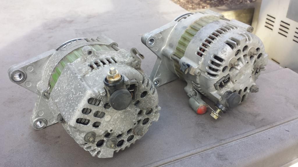

Here is a pic of a GW and Valkyrie alternator.
You can see the front is the same, but the rear, where the wires connect are in a different location. I believe it's not the 4 bolts, but those 3 Phillip head bolts, that you remove, and rotate it one hole till it matches the alternator for the bike you are installing it into.
As for which GW alt (or was it a different post?), they are all the same, a GL1500. GW is from 88'-00'. If you have a radio on your bike, you want that capacitor you see there.
I would be hesitant to buy a new alt, I would rather R&R my own from the bike. I think I paid $25 for a spare, which I could rebuild.
