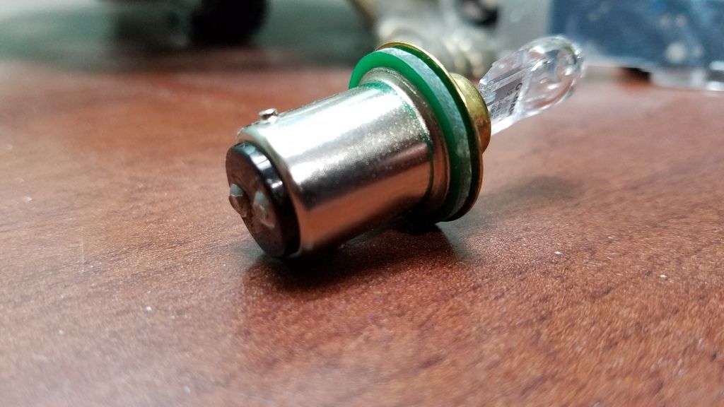

OK, fixed it.
Since there was obviously no little black box, and the brow/green pair hadn't been cut into, it had to be the bulb.
Sure enough, I pulled the bulb out and it has a little circuit board at the top of the base.
I put in a standard taillight bulb and all is well.
I'll have to do a search for another bulb like that.

Well, that didn't take long.
Here's the one I had to replace:
http://www.revzilla.com/motorcycle/kuryakyn-super-bright-pulsing-bulb?utm_source=product&kwd=&gclid=Cj0KEQjw4827BRDJvpbVuKvx-rIBEiQA2_CzsK0eimmbNSnmj-L81EdFJm7LUyVLh-eGQ__g2s_6FRYaAsaq8P8HAQ
Here's an LED verison, that I'm going to buy:
https://www.superbrightleds.com/moreinfo/tail-brake-turn/1157-led-bulb-w-brake-flasher-dual-function-1-high-power-led-bay15d-retrofit-car/923/
