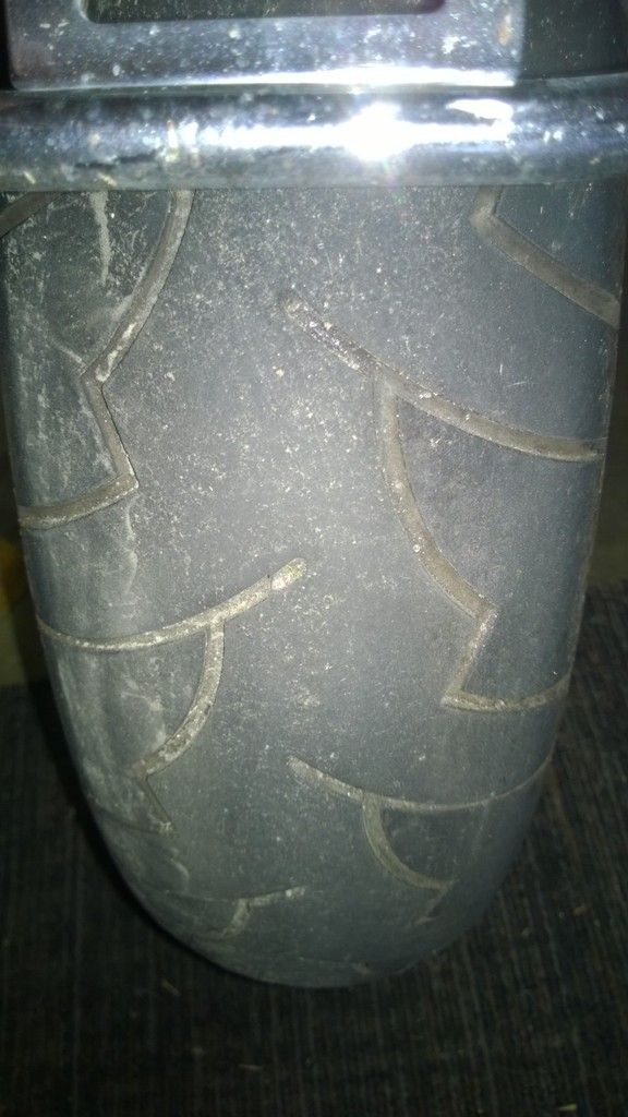

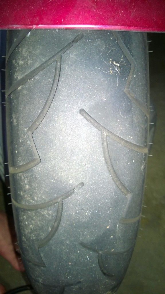

I was ordering a new front tire for my 93 daily driver Redwing and saw that they offer it in the stock front Valkyrie size now instead of a 130/90-17 like many of us have used. I'm fine with the 130, it's firmly planted.  coolsmiley Until the NEXT tire, that is.
For what it's worth, the 93's Activ did NOT wear out yet, at 34,000+ miles. I'm simply replacing it because the rear ATT WORE OUT in the center, same mileage (45 psi). The Activ on front did feather and roars in the curves, but it would still pass inspection, by far.
https://www.cyclegear.com/tires/michelin-pilot-activ-rear-tire
http://www.bikebandit.com/tires-tubes/motorcycle-tires/michelin-pilot-activ-motorcycle-tire
Here's the one on my Valk IS with about 15,000 miles on it.
This picture shows an E3 mounted and the Activ reversed to match the tread siping direction.

Found a 1/4" gouge on the sidewall / tread edge yesterday (post-wash) while checking pressure so I'm ordering a new Pilot Activ in the 150/70-17 size.  It just passed inspection last month and I'm sure there's at least another 10k miles of tread left; it is feathering a bit on the edges.
I've been happy with the 130/90-17 size for these two years and 21,600 miles, but I'm not going to chance having this gouge cause a blowout. It may even be the reason I found 32 psi in the tire yesterday (I run it at 42 psi). It does lose pressure but it's never been more that 3 or 4 psi low after sitting a few weeks, which is typical. It hasn't had a good long trip in a couple months but I like to have it ready.
Hoping I like the "closer to stock" size!
