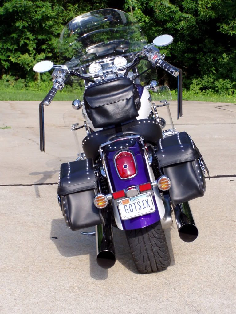

I have 2 Valks, an I/S and a Std.  Everyone was saying how a car tire was the way to go. So, the cheap bastard in me thinks...cheaper, more mileage, conversation starter.....OK.   Posted messages to see if anyone else was using the tire I decided to go with, and sure enough a few guys in Canada were running it.  Said they liked it.  After putting the tire on the Std,  I didn't go 30 feet before going over a speed bump. I didn't approach it straight on...why would I?  Right then and there it almost threw me off with the bike making a violent shift from left to right.  I thought to myself, what in the hell did I do to my bike...putting this tire on?
It rode real nice out on the concrete Interstate.  Blacktop secondary roads, where most of my riding is done was a whole different story.  On 3 separate occasions, it scared me so bad, I thought I was going to die.  Needless to say, that bike didn't get ridden much.  Then I met the Lady I would marry...when she seen that Purple and White Std, she laid claim to it right there.  I only let her ride it a few times with that tire on there.  She claimed it was alright, but when I change it back to a MC tire, she thanked me profusely.  Come to find out it scared her also but didn't want to say anything.
Riding a cruiser style bike shouldn't be exhausting.  That's what it was like riding with a car tire.  Having to muscle the bike around corners and through curves and trying to keep it going straight down the road isn't how a motorcycle is supposed to handle.  I'd be going on my merry way when all of a sudden it would want to shoot me towards the ditch or into oncoming traffic.
If you pay attention to what the CT users say, it should send up a red flag, but I didn't pay attention.  They will always state...."once you get used to it".  My opinion is that you shouldn't "have to get used to" the tire you just put on your motorcycle.  A motorcycle should fall into a curve or corner with very little input to the handlebars. It shouldn't be a chore.
So now, I just think of it as an expensive experiment. I know several people who are using a CT.  They say they like it.  OK......  It's their bike and they have every right to do what they choose.  And possibly, the tire they have handles much different than the one I tried.  But for me?....I'm pretty certain that I will never try that "experiment" again.
BTW, the tire I tried was a Dunlop Sport........
