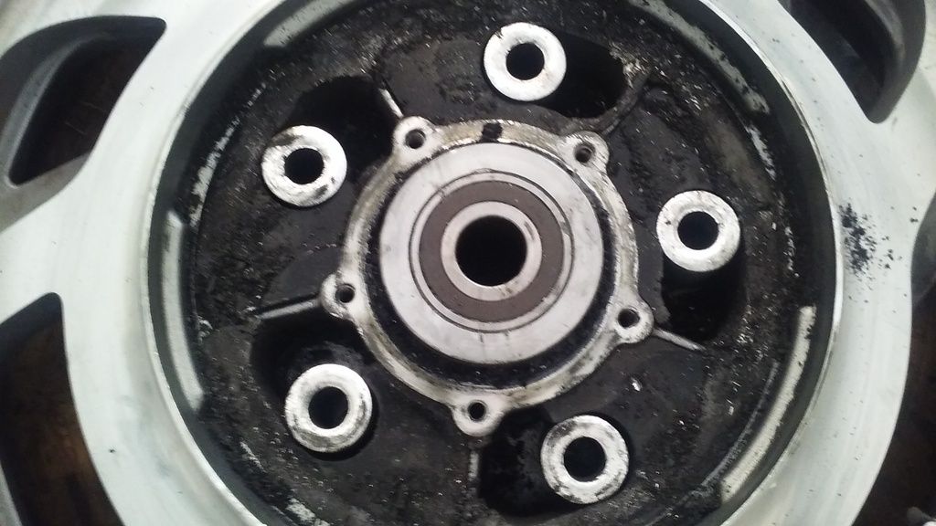

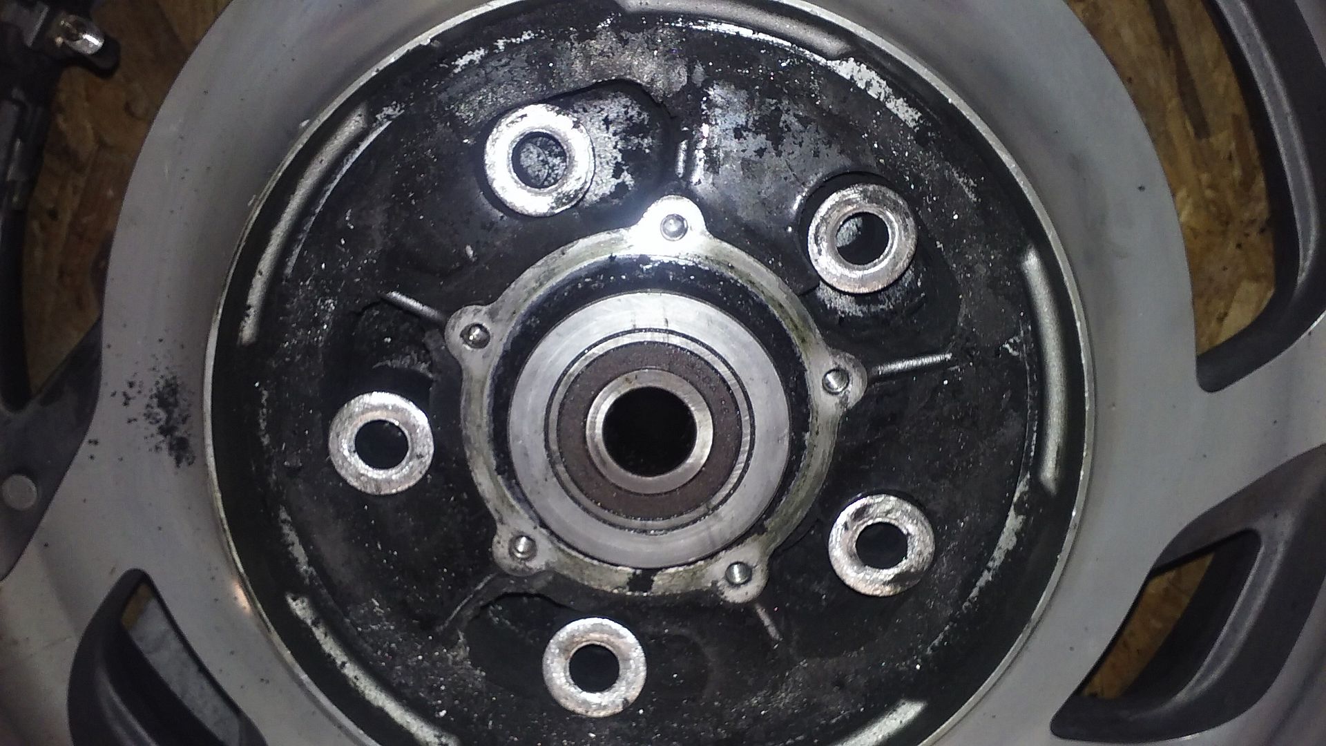

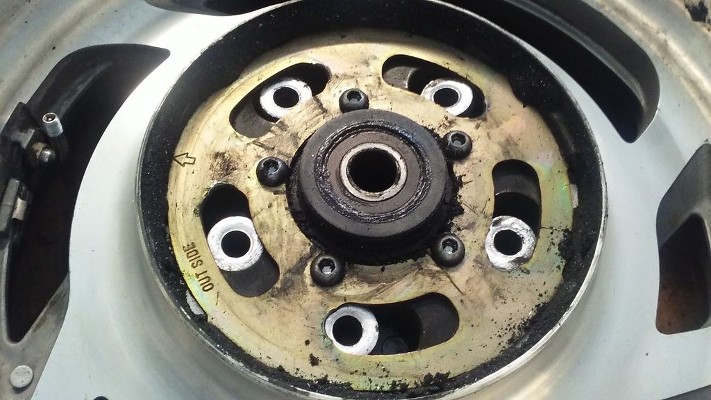

Took rear wheel off only 1500 miles after BigBF had serviced the rear end.
Went to get a new tire put on.
Git home. Put wheel with new tire up on work surface to clean it up.
This has NEVER happened to me in over 80,000 miles of Valkyrie riding. This bike now has 45,000 miles.
« Reply #1 on: September 27, 2016, 11:56:49 AM »

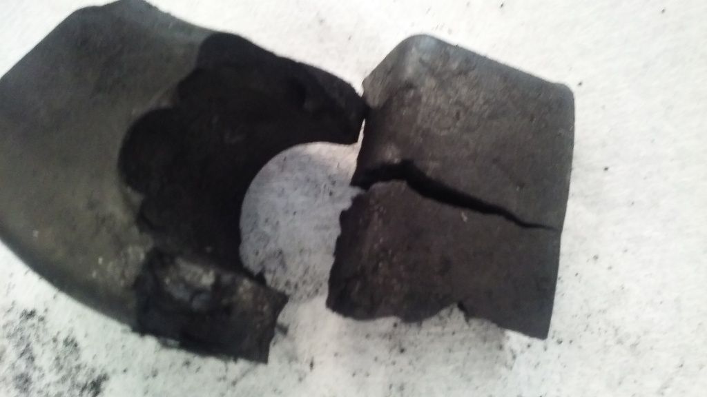

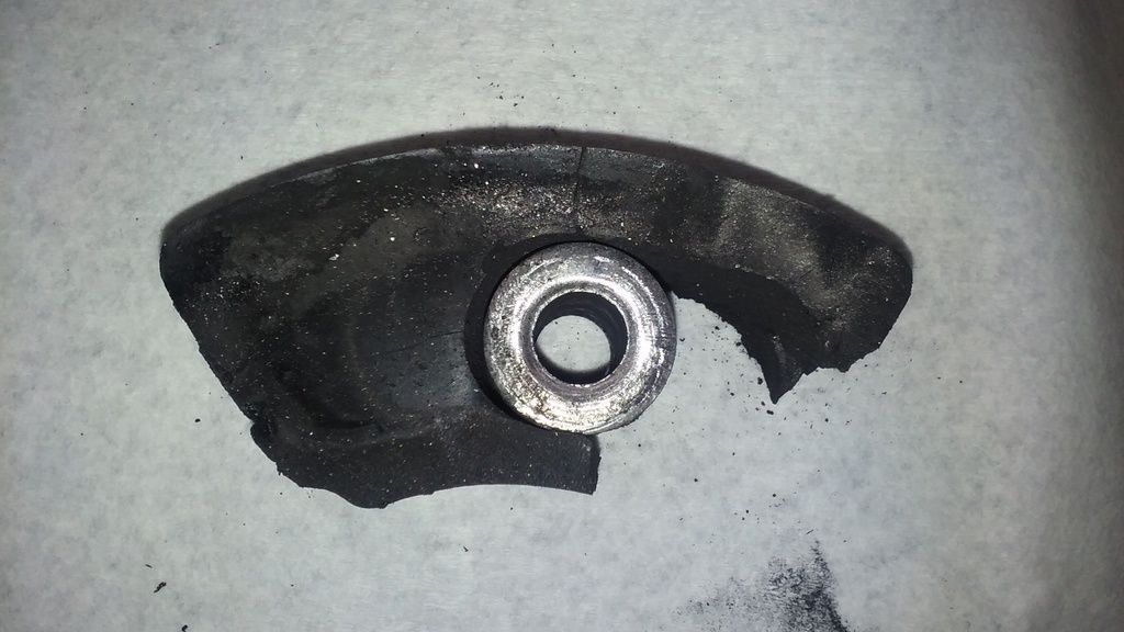

I just got back from a 3 day 800 mile ride and the bike felt fine  Shocked
The rubber was so f'ed up I could split it by hand with very little force.
So dry I used a shop vac to suck out the rubber dust  Shocked
Where does this go?

« Reply #3 on: September 27, 2016, 12:00:49 PM »

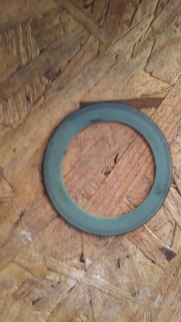

A fellow, Gary, who has since passed, used to make dampers for Valkyries.
It turns out he had a bad batch, maybe you don't have OEM dampers?
Order Interstate dampers to replace them, they are better and cheaper.
The "what is this" is your crucially important thrust washer that goes
into the back of your flange, don't leave it out...

Would the OEM have a part number embossed on them?
« Reply #6 on: September 27, 2016, 12:07:19 PM »
I haven't held any OEM dampers in my hand for a while, I don't remember.
But when people post pictures of Gary's dampers turning to dust, it looks
like the pictures you posted. I've never seen OEM dampers fail like that,
they just slowly wear out and get loose (that I've seen)...

« Reply #8 on: September 27, 2016, 12:20:07 PM »
The thrust washer isn't shown on the Partzilla fiche.
Bone

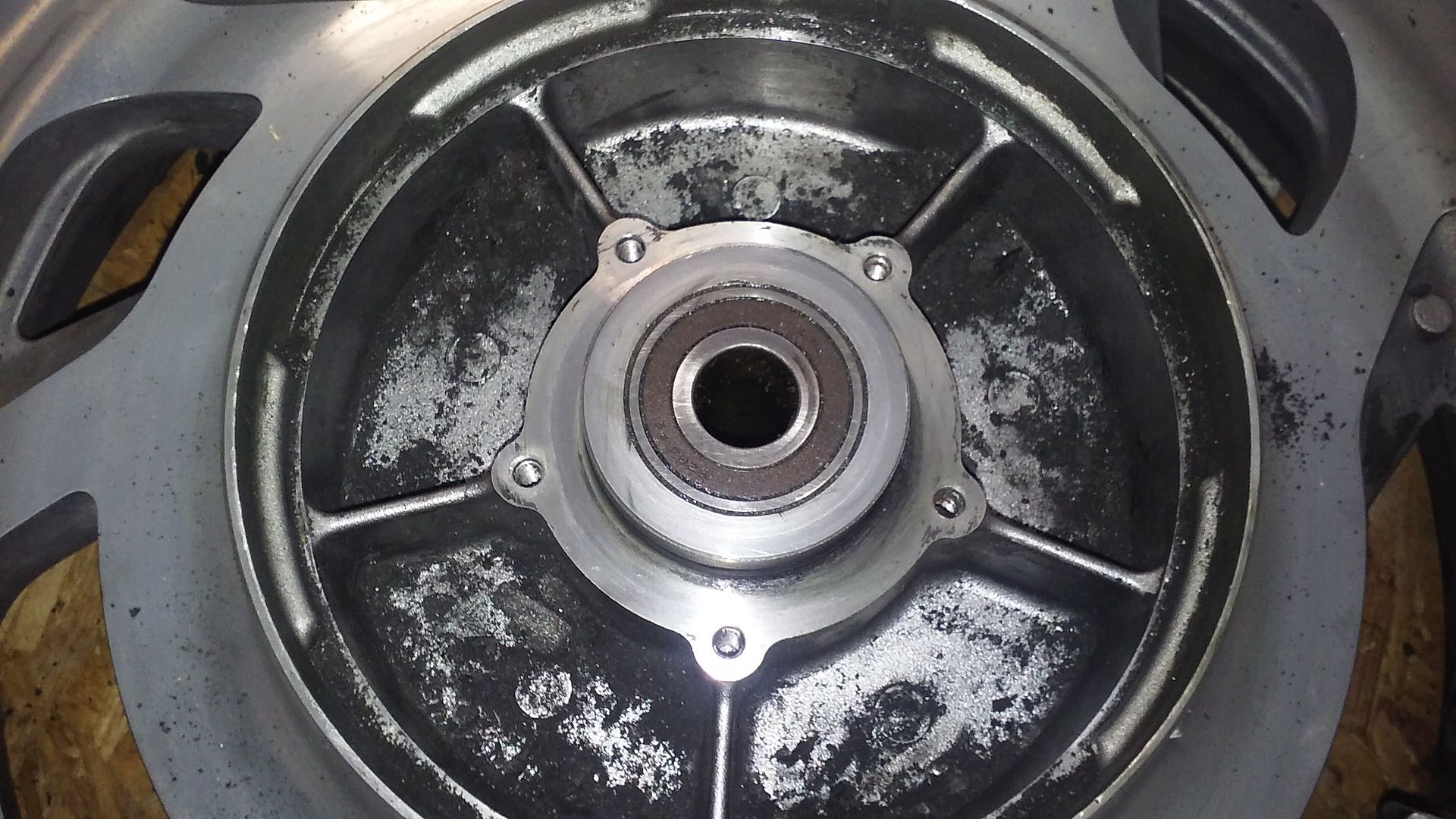

« Reply #12 on: September 27, 2016, 12:34:25 PM »
It goes "in the back" of the flange. When the flange is installed
in the wheel, the thrust washer prevents metal-on-metal contact
between the flange and the wheel. Notice how it fits exactly
where the flange will be in this picture:
« Reply #13 on: September 27, 2016, 04:23:45 PM »
I went out and looked at mine. I have some new and some with 50k on them. They only have the word "outside" and a number of A1-A7 molded into the rubber. I think Mike is right, you've got a set of the bad batch ones from Gary. Make sure you put some grease on the thrust washer.
Posts: 31197
« Reply #14 on: September 27, 2016, 04:32:42 PM »
All of Gary's were urethane, even the bad batch.  I have two of his good sets going strong.
All the OE's are rubber.  They don't crumble.
« Reply #15 on: September 27, 2016, 05:06:51 PM »
Those Dampners are not OEM. The OEM I serts are not round on the outside as those .

take the new ones back.
You may be surprised at the difference new ones will make in "feel". Even if the originals look good.
« Reply #19 on: September 28, 2016, 11:10:28 AM »
Got it.
The enforced wait for new dampers has given me the opportunity to give parts of the bike normally out of reach a good cleaning. I've now got another good coating of wax on the metal plates below the saddlebags and on the back of the saddlebags as well.
They should be arriving this pm. I got next day service from Partzilla for an extra $2.00

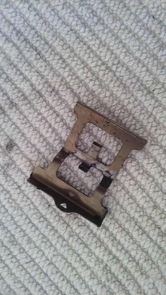

« Reply #23 on: September 28, 2016, 05:54:28 PM »
Britman, if you need the plate that holds the dampers, let me know. I have a good spare one.
« Reply #24 on: September 28, 2016, 06:34:02 PM »
Mine will work. Thank you.

I found it easiest to slide the bracket in from under the axle and then rotate it anti clockwise.
This after putting the axle in from the wrong side to get everything lined up and held in position.
NOW THE NEXT PROBLEM IS
How the hell do I get this spring thing back into place???
If I have to take it all apart again so be it.
I've tried to remove the pin that goes through the brake pads but the last owner has it tighter than a ducks butt in water. I thought removing the brake pads would make it easier. I couldn't get the spring plate thing in with the caliper free of the bike. No matter how I set my mouth.

« Reply #32 on: October 01, 2016, 08:07:59 AM »
I don't see a connection to the wheel dampers which is the subject of this thread, but will answer your post anyways. You can run without that spring in the caliper and it will not affect anything in a real way, but there may be some additional noise generated from the pads clacking aqainst the rotor and there also could be a little accelerated wear to the pads. That's about it.  The pin needs to be removed to be able to replace the pads and properly return the spring to it's position. You'll eventually have to do this!
2000_Valkyrie_Interstate
Posts: 14935
« Reply #33 on: October 02, 2016, 07:13:50 PM »
At the most you will have to pull the pads, should be able to do that without messing with the axle nut.  I wouldn't run without it, no way
