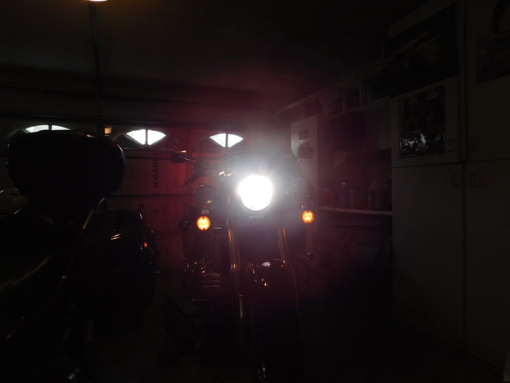

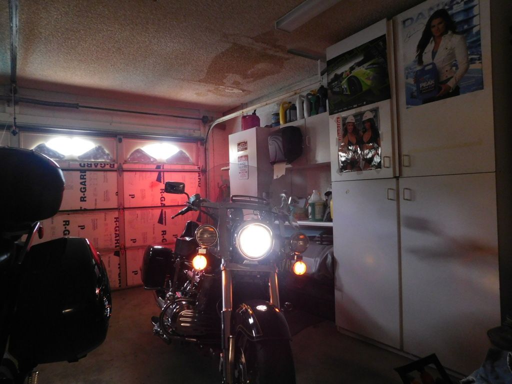

I just finished installing BONS switch on my '98 Tourer. Before and after pics were both shot with the engine running at 1000 RPMs. The brighter lite caused my camera to reduce the aperture so the background looks darker. The difference in brightness is even more pronounced.
« Last Edit: October 12, 2016, 02:22:56 PM by sandy » Logged
