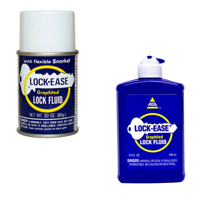

« Reply #4 on: October 18, 2016, 07:01:13 AM »
NOT WD40!  Use a graphite lock fluid, like Lock-Ease; the fluid evaporates, leaving the graphite, which lubricates the lock.  WD40 will leave an oily film, which attracts dust, which you don't want in your lock.

BnB Tom
Posts: 1708
Where'd old times go?
Frisco, TX
« Reply #12 on: October 20, 2016, 05:23:49 AM »
  More than once I have had to completely rebuild a lock that was treated with a graphite lock lubricant because of the dry, hardened residue that was left behind in this humid, N. Texas area.
   As a flushing liquid, WD-40 works great!  (WD-40 is a WATER DISPLACING OIL - 40th Formulation).
   However, Tri-Flow (which has no graphite in it) along with a few other non-graphite based lubricants is the only type of products recommended by high end security lock manufacturers.
