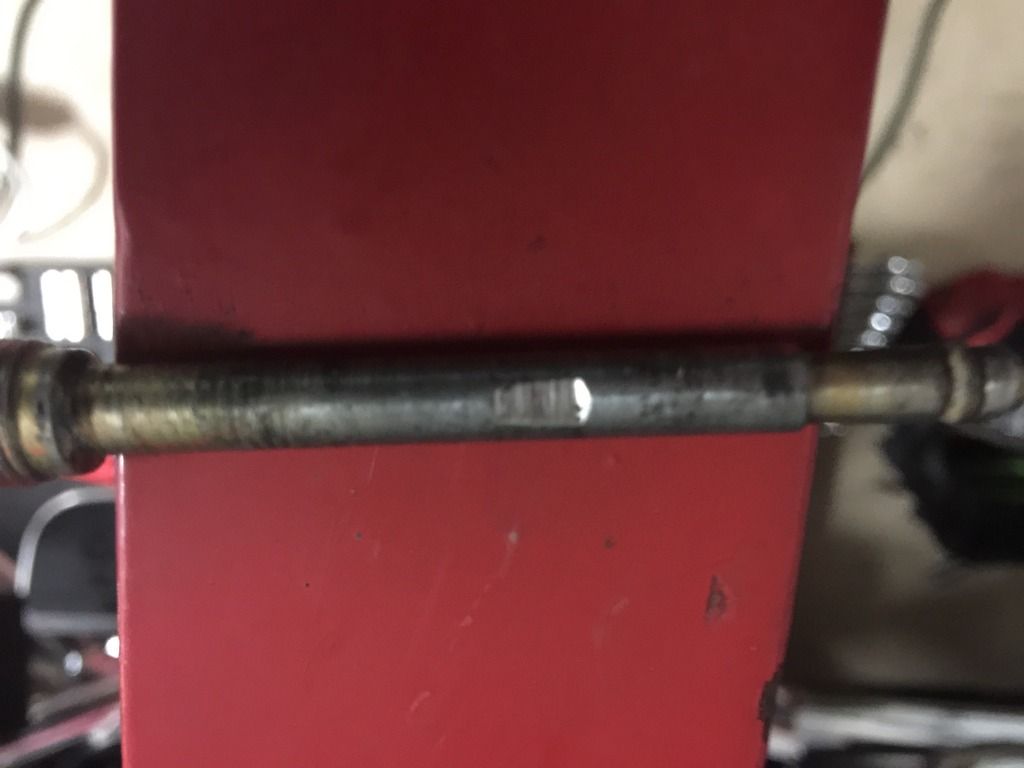

A friend of mine is having an issue with his VTX1800.
The pad retaining pin is comming into contact with the rotor:
I helped him install the new brakes and verified that the rotor was clearing the pin at that time.
Even though it's a VTX1800 the set up is very similar to our Valks, I simply cannot figure out how this could've occurred.
The only thing that I could think of was that the rear caliper bolt had came loose, but he says it was tight.
Any help is appreciated and Thank You in Advance.

Well, your friend is obviously mistaken about the bolt being tight. You can see by looking at the wear on the bolt that it was at an angle when it wore which indicates it had been unconnected at the end. Put the bolt back in without the pads and you'll see that in order to have every condition satisfied the bolt had to be loose and out some.

Thats the pin showing the wear.  The pin can be loose as it goes into a hole on the other side of the caliper so it still shouldn't rub.
The only other possibility would have to be bearings.
He was certain that the rear caliper bolt was tight, as opposed to the pad retention pin being tight, but good catch on the angular wear pattern.
3fan4life, does the wear mark now line up with the rotor?  If Ricky-D is right, the pin would not have been screwed in far enough, and now that the pin is tight, the wear mark should be farther in than the rotor.

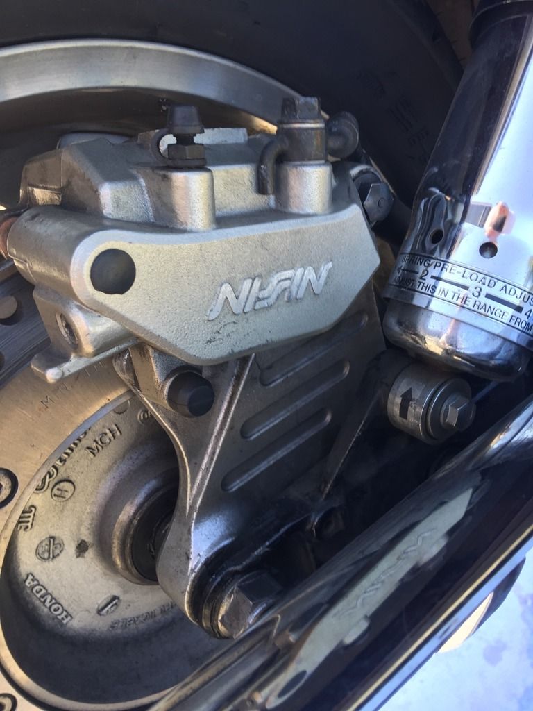

I found a downloadable shop manual for the VTX 1800.
Apparently there is not a bushing that belongs in either place.
The manual recommends replacing the Rear Caliper Stopper Pin Bolt (Part #17) every time that it is removed.
It calls it an ALOC Bolt.
That's the first time that I've ever seen anything stating to replace that bolt with a new one.
Does anyone know why that's the recommendation and if it's really necessary?

I THINK THAT I FOUND THE PROBLEM.
Putting everything back together over the weekend I discovered that the Bolt Pin was slightly bent.
Shown here as part of the bracket assembly:
http://www.partzilla.com/parts/search/Honda/Motorcycle/2007/VTX1800N1+1A/REAR+BRAKE+CALIPER/parts.html
The parts diagram for the VTX does not list it as a separate part.
I recognized it as being the same as the one on the 1500 Valkyrie (part #13):
http://www.partzilla.com/parts/search/Honda/Motorcycle/2000/GL1500CF+A/REAR+BRAKE+CALIPER/parts.html
We couldn't be guaranteed to get one before Oss' ride this weekend.
So, I "Borrowed" one from one of my Valkyries that is awaiting Big BF's attention.
The clearance is still close but it looks better and the caliper is sitting nice and straight.
Keeping fingers crossed that this was the problem and everything is now Good to go for our trip to New York this weekend.
