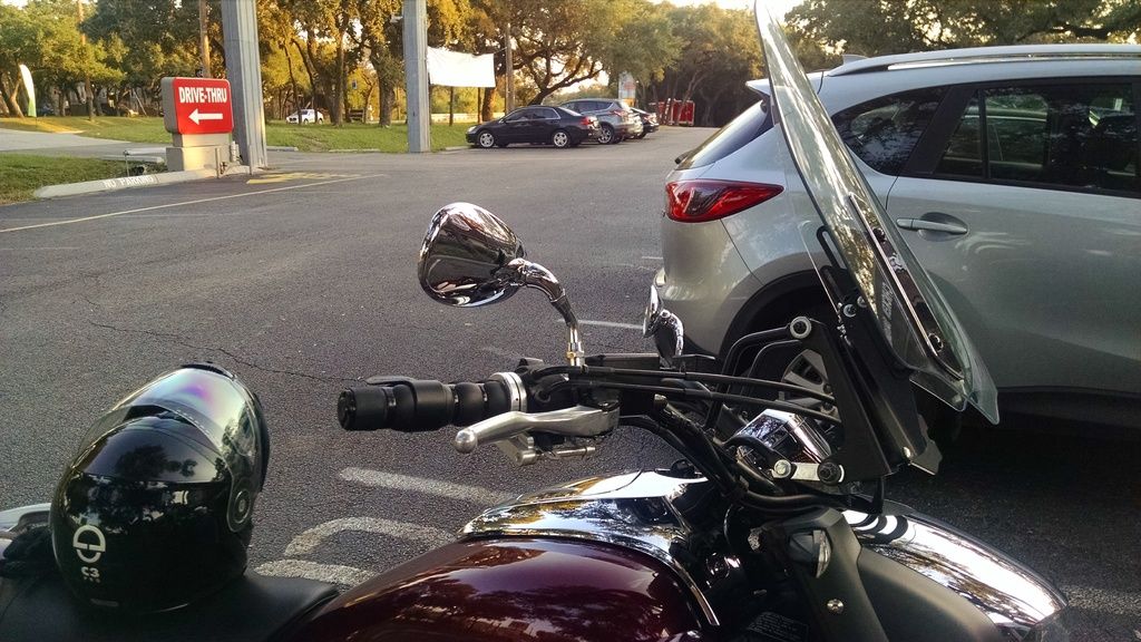

Somehow my wife and I have managed three weeks off from work and we spent the first week with two different couples both we know from the Florida VRCC rides who have houses in North Carolina.  For the second trip where we logged 2151 total miles we just rode the bike, however for the first trip we decided to try renting a hightop cargo van from Enterprise and wow did it work well. The van has 10 tie down points and I used a wide wheel chock.  Four days after returning from the first trip we took off on the bike to meet up an hour later with three other bikes to head off and pick up VRCC members in the panhandle of Florida. 300+ mile days with a couple of days over 400. Ok for some thoughts on the bike, the Corbin seat I really give it a 10. I know it is very hard for the driver but it just fits so well and the passenger seat is definitely more padded nonetheless my wife gives it a 10 as well, amazing to not have any monkey butt or soreness at all!  Handlebars (I realize many do not like the stance on this bike) the handlebars are good as well with no complaints.  The not so good: rear suspension is rated 375 pounds on the C whereas the B is 410 and me at 236 the wife and luggage it would be more suited to the B.  Don't get me wrong, I am glad my wife loves this sport and getting back rubs while on the bike is a huge plus. I'll bet if I wanted to go on a longer trip she will always say not without me you don't!   I do feel the C is more suited for one up. Next is wind and the windshield.  After this trip I wanted to try something of a project and see if I can't get something that is more dialed in, both for less wind buffeting and better personal aesthetics.   So I have this old scratched up windshield off a 1500 Valk tourer and I modified it to fit.  Instantly I am way more at home behind this, it looks way better and has reduced the buffeting.  I wish I could say it eliminated it all together but I just wonder if having something that looks good will come with a price.  I will leave this on for a few weeks and if I continue to like this as I do after the first ride I will check and see if clearview has a tourer windshield with a blemish on the bottom half and pick it up.   Thoughts?  http://s1370.photobucket.com/user/EBeybuzzard/slideshow/1800%20tourer

             That windshield looks right at home on your Gen 2 Valkyrie. Ingenious craftsmanship. You would think a after market item.
Thank you and it is, I still have a 1500 with that windshield on it and it felt right the second I got behind the h-bars.
